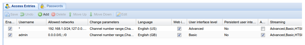

Can you get in if you set the access mask to 0.0.0.0/0? Or add 127.0.0.1 to the access mask. See here in the tvh help screen:
Thanks @grahamh, I kept the username and password for the access entry the same and added 127.0.0.1 to the allowed networks. So it is now:
192.168.1.0/24,127.0.0.1
And it works! I’m glad that it works, but I find it odd that I needed to do it…:thinking:

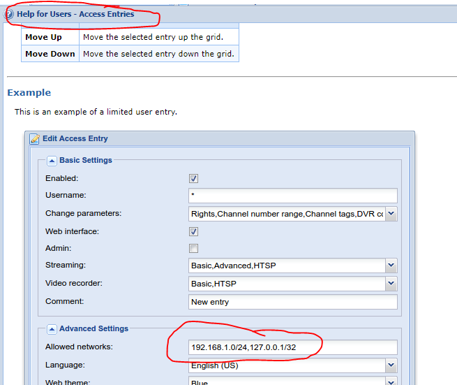

Glad to hear that’s working, now. Well at least the tvheadend help displays this solution as an example:
Are you sure the client was set to 127.0.0.1 and not 192.168.1.x?
I’m not 100% sure :wink:, and the circumstances regarding this issue and how it was resolved do make me doubt my memory regarding this.
That’s really good to know. I wasn’t aware that there was information regarding this in the Tvheadend help.
