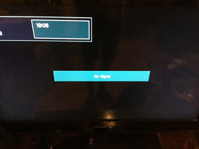

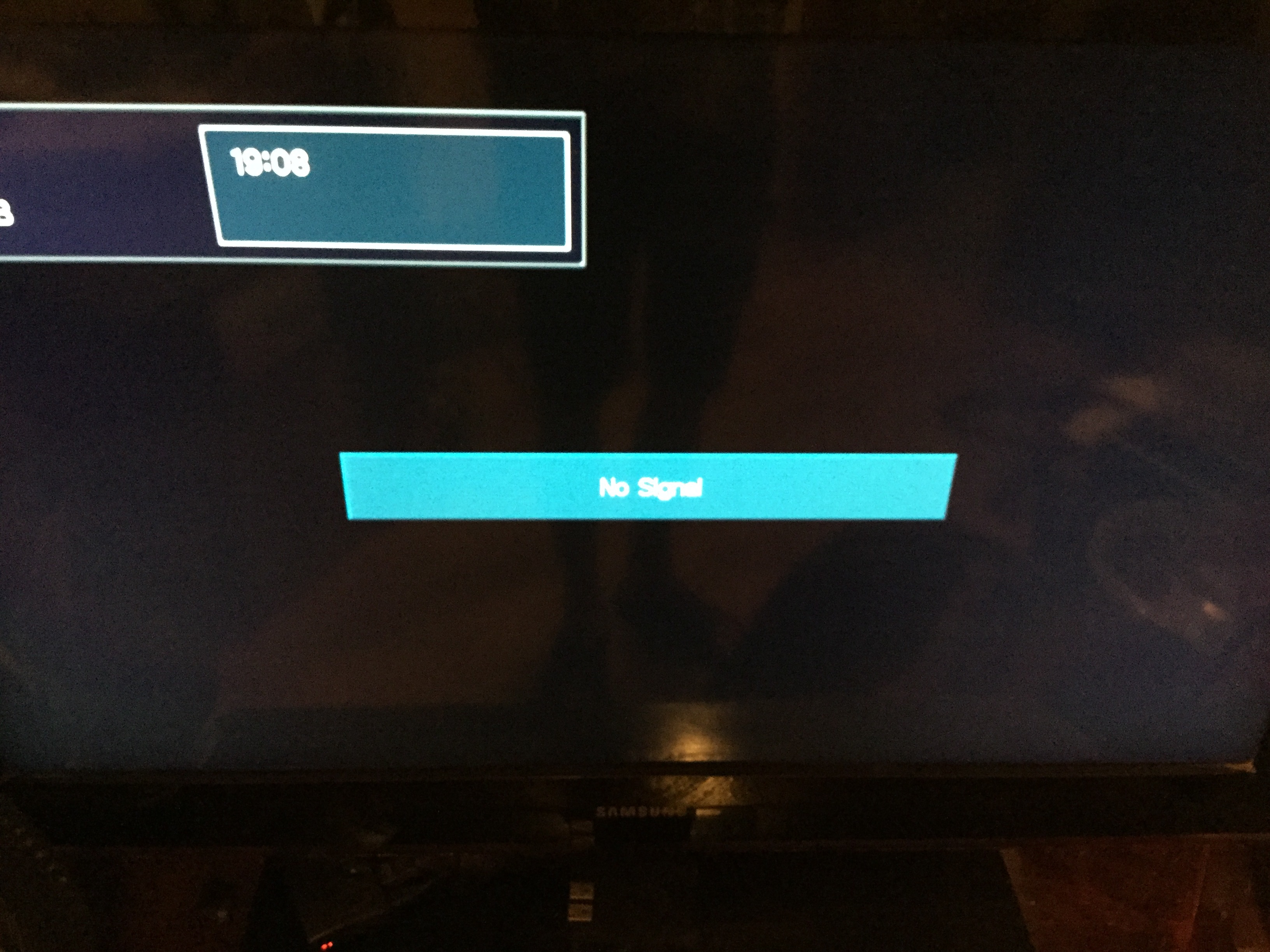

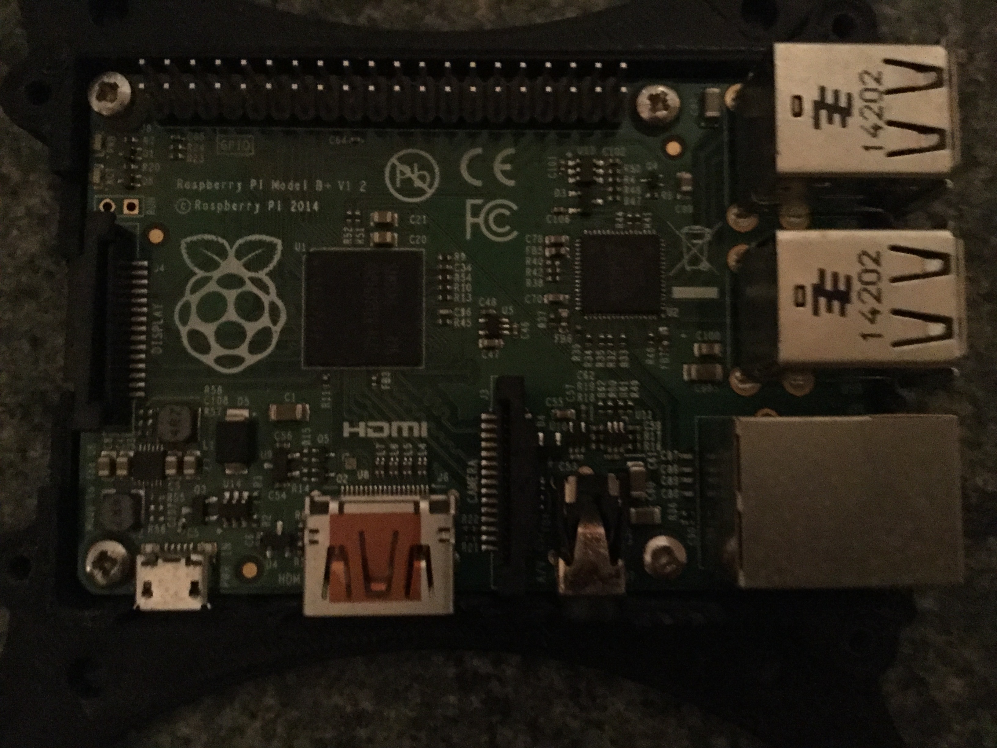

If OSMC installs successfully, you will know it. Take a photo of your board and the tv screen output
These are my pics after instal the screen is just black. The install seams to go ok and completes to the end of the progress bar
Ok guys. Finally managed to solve this 1. The problem was a faulty sd card. Got a new card and it worked straight out of the box
