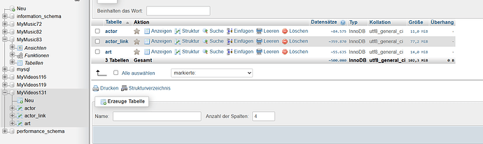

Database MyVideos131 seems to be incomplete?
What do you think?
Should I delete MyVideos131 and try to start Kodi again? Will this eventually start a new migration?
Should I delete MyMusic83 too? (As I do not use OSMC to store music it will not be used anyway but I ask to ensure the best way to retrigger a migration / convertion)?
I’m guessing if there’s no MyVideos131, Kodi will create it and migrate the data from 119 and won’t care about MyMusic. I think @darwindesign uses MySQL and may know.
Correct. If Kodi does not find the current version database it will look for the previous version to update, and then failing that will look to see if there exists the previous one to that, and so on and so forth until it runs out of versions and then it will just make a new empty database. It works the same using MySQL as it does with a local database in this regard. The only potential difference that comes to mind is that a MySQL setup that used a name tag in advancedsettings.xml would have a different database name.
Check the version of Maria that your using against Kodi’s wiki on the topic. I think there is issues using too old of a version of Maria or MySQL with more modern version of Kodi.
If you drop or rename the database in Maria, or add/edit the database name tag in advancedsettings.xml then Kodi will automatically create a new empty database. If you have a current working setup you could in Kodi do a export to seperate files which would export your metadata including watched status. Importing watched status is now default so you don’t need to add that advancedsettings.xml anymore. One caveat with doing this is make sure you configure that same TV show scraper for TV shows as the old one. If the nfo files are pointed to TheTVDB and your scraper on the new setup is set to TMDB then those series will not scrape new episodes without some intervention.
