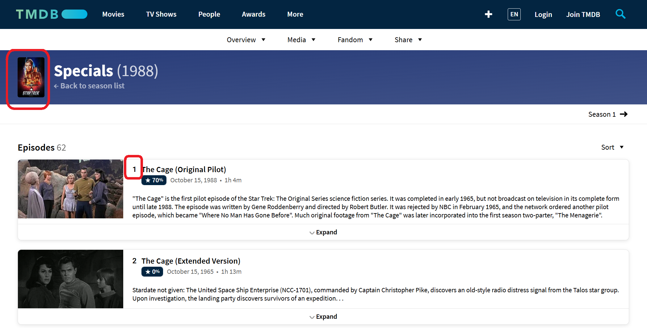

It isn’t a Vero thing but rather Kodi and the skin makes no difference. The first thing you need to look at is the scraper you are using and its settings. Assuming you are using the default scraper TMDB or TheTVDB a file organization that should would very reliably for this file would be [TV shows source]\Star Trek\Specials\s00e01 - (this text is ignored).[ext]. Optionally instead of a “Star Trek” folder you should also be able to use “Star Trek The Original Series” and that should work as well.
If you don’t care and just want that one episode to show up correctly then just copy the following into a text file and save it at the same location as the video and name it the exact same name but with a “nfo” extension. Do note that with many text editors on windows if you are hiding extentions then you might need to go to explorer, show extensions, and then rename .nfo.txt to just .nfo.

I guess this is the problem, you see.

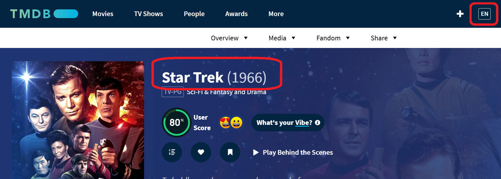

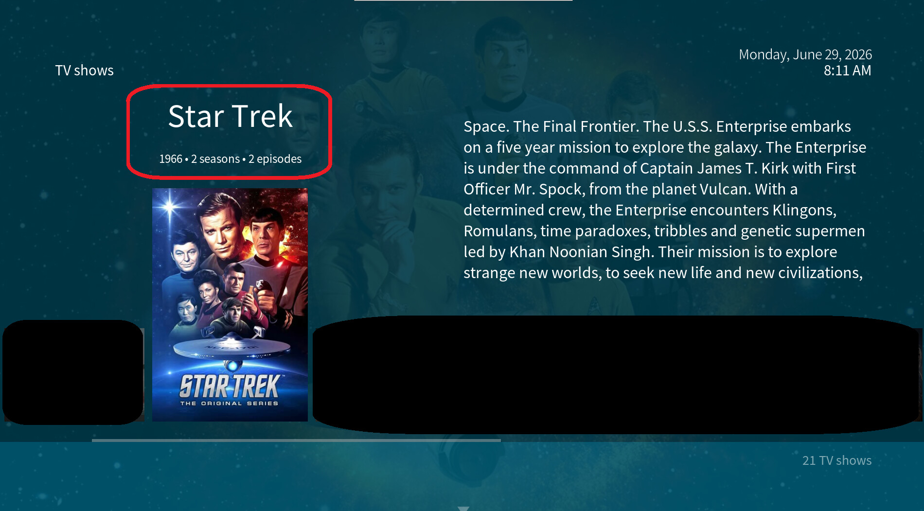

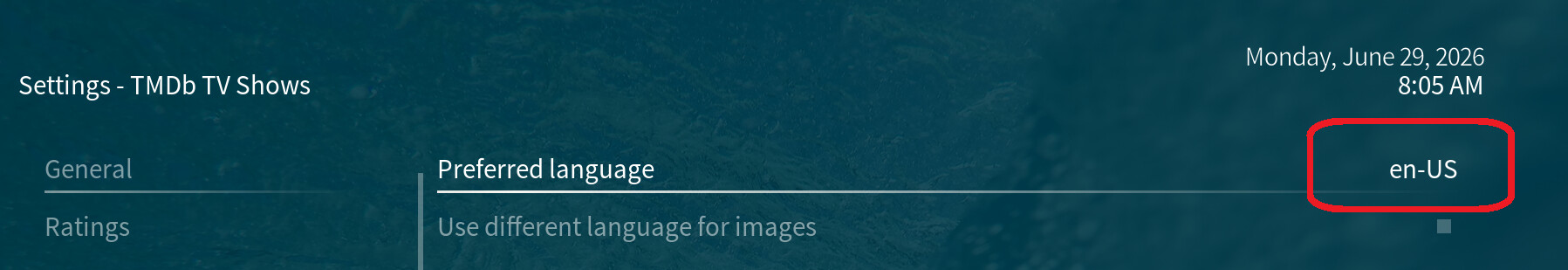

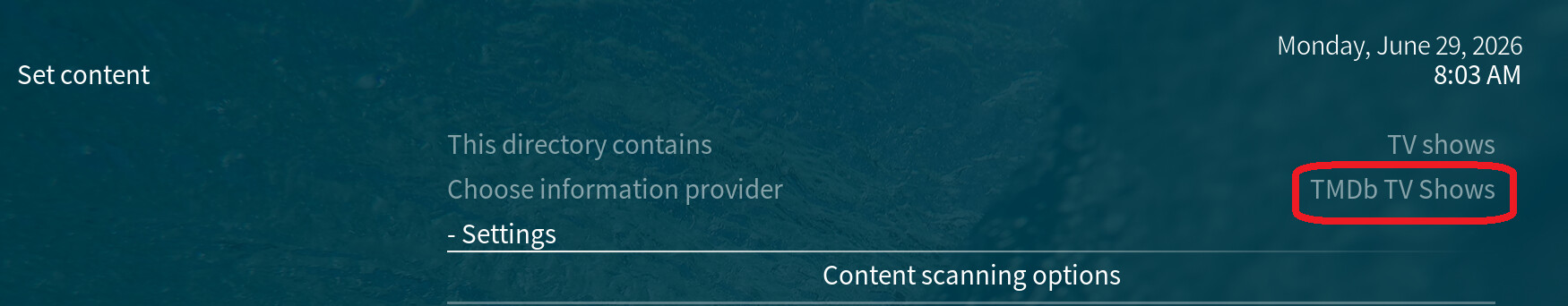

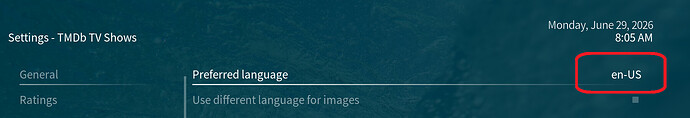

Here I’m using OSMC skin, scraper ‘TMDb TV shows’, language en-US in on the tmdb.org web page and in the scraper … and everything works out the box:
I think the correct year information is mandatory since there is an animated series ‘Star Trek (1973)’ as well.

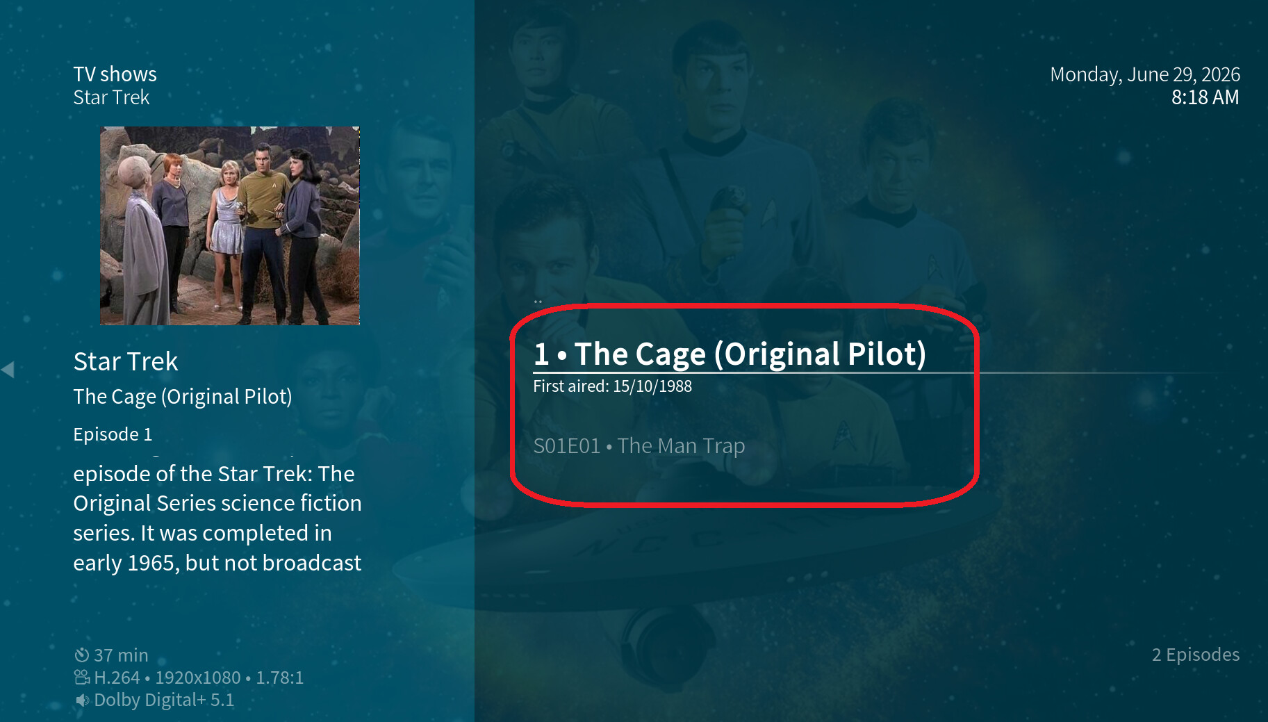

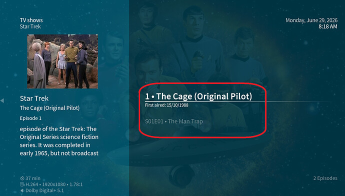

That worked! Dropping the .nfo in my deployment folder with all the VOB files and naming it with the same prefix as the parent folder.
Thanks !

and since there is no option with the year added I’d expect that to have issues auto scraping. The movie scraper parses the year from the file path and including that in your movie file naming is highly beneficial, but my experience is the TV shows scrapers work a bit different.
FYI the error you originally made is that the folder doesn’t have the year in parenthesis. This matters due to how kodi parses the path to extract the title to pass to the tmdb scraper. The TMDB scraper first sends title+(year), and if that fails to get a match it drops the year and resends just the title. Kodi identifies the year by looking for a four digit number within parenthesis. You’re lucky that TOS occurs before the animated version with the same title (but different year).
Instead of it being Star Trek 1966 it should have been Star Trek (1966).
The way you named the folder the scraper was looking for a show titled “Star Trek 1966”

For several months a while ago tvdb had one of the aliases as Star Trek (1965) instead of Star Trek (1966).
That “.nfo” file for The Cage (Original Pilot) worked great, but I want to get the “Extended Version” as well….
What I really want to know is how you generated the “.nfo” file so I can generate one myself for the Extended Version.
So how do I do that exactly? I found something about it on Kodi, but where do you scrape the .nfo from?
There are various ways but in my case I just pulled it out of my own personal library. I generated mine with a media manager (on a PC) called Tiny Media Manager (TMM). TMM, like most media managers, you point it to your media locations after setting your preferences for how you want it to handle your files and generate media info. You are effectively “scaping” on a PC and then when Kodi updates and sees the metadata files it uses them instead of looking on the internet.
I already also had that one so here you go…
