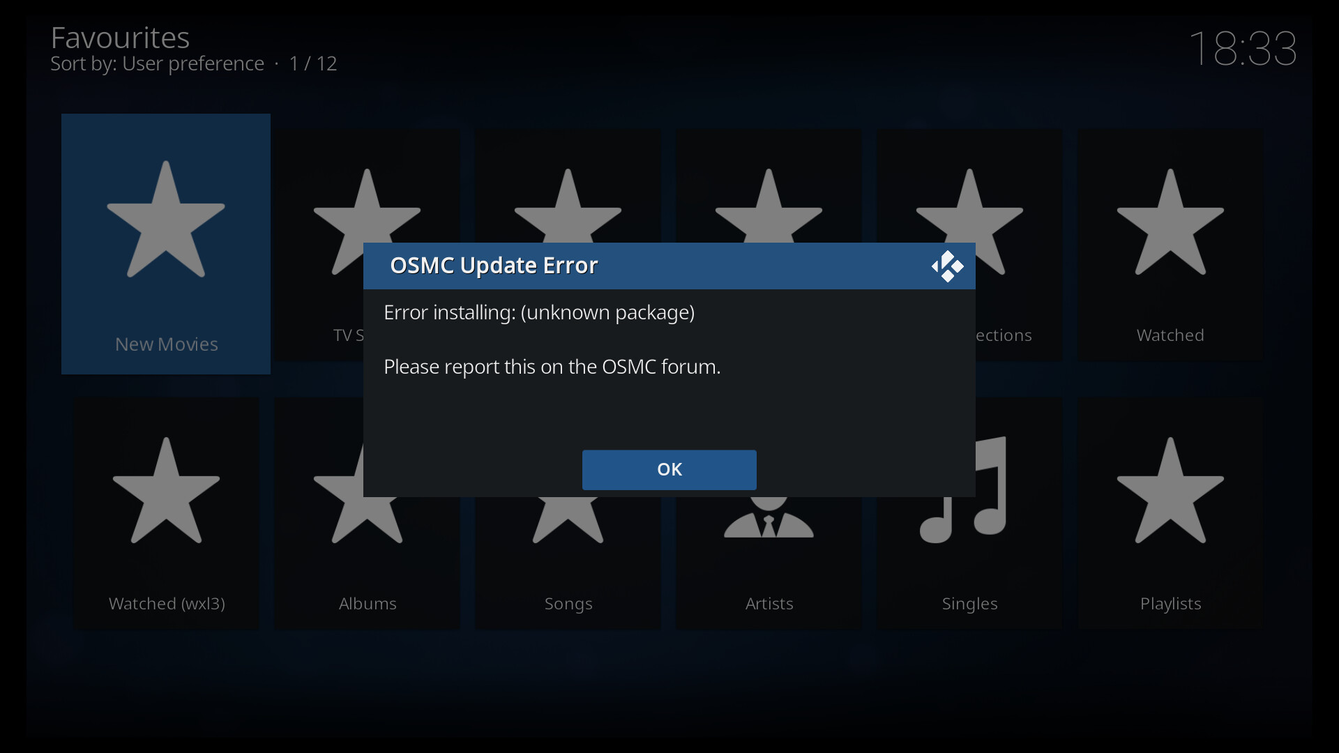

Just had a notification that there is and update. After a message that the update failed I received this…
So, as requested, I’m reporting it…
How long should applying the fix take and should I get a message when it is done? My attempt asked me if I really wanted to do it, I said yes and it did not come back with any message. The cursor is active and I can get back to the menus and operate, but I have no confirmation that the fix was applied.
The confirmation comes when you can update again. Scroll down in the above post.
Can confirm. Even trying to update from the command line fails because the repos have been moved.

Some manual intervention will be necessary to correct the sources.list and update to Debian 11
If you run follow the instructions in the link that Graham has linked to, updates will work just fine.
Please try that and get back to us if there’s an issue. There is some manual intervention, but it can be done via the comfort of the My OSMC interface.
Got it. Thank you.
