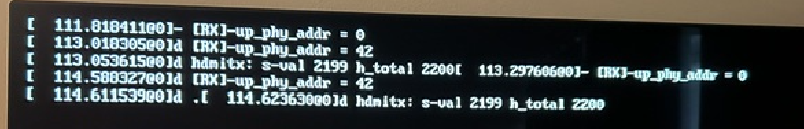

I have had an auto mounted USB drive connected to my V via the USB 3 port for a few days and have been accessing the drive’s content without issues. The V was suspended at night and the next day the drive was still auto-mounted, however that drive stopped showing as auto-mounted. I have tried rebooting ( the V was stuck a couple of times on the log view that I am attaching below) and tried power off and power on. The drive still remained unmounted. Tried another drive and same issue. No auto-mounting on either of them.
