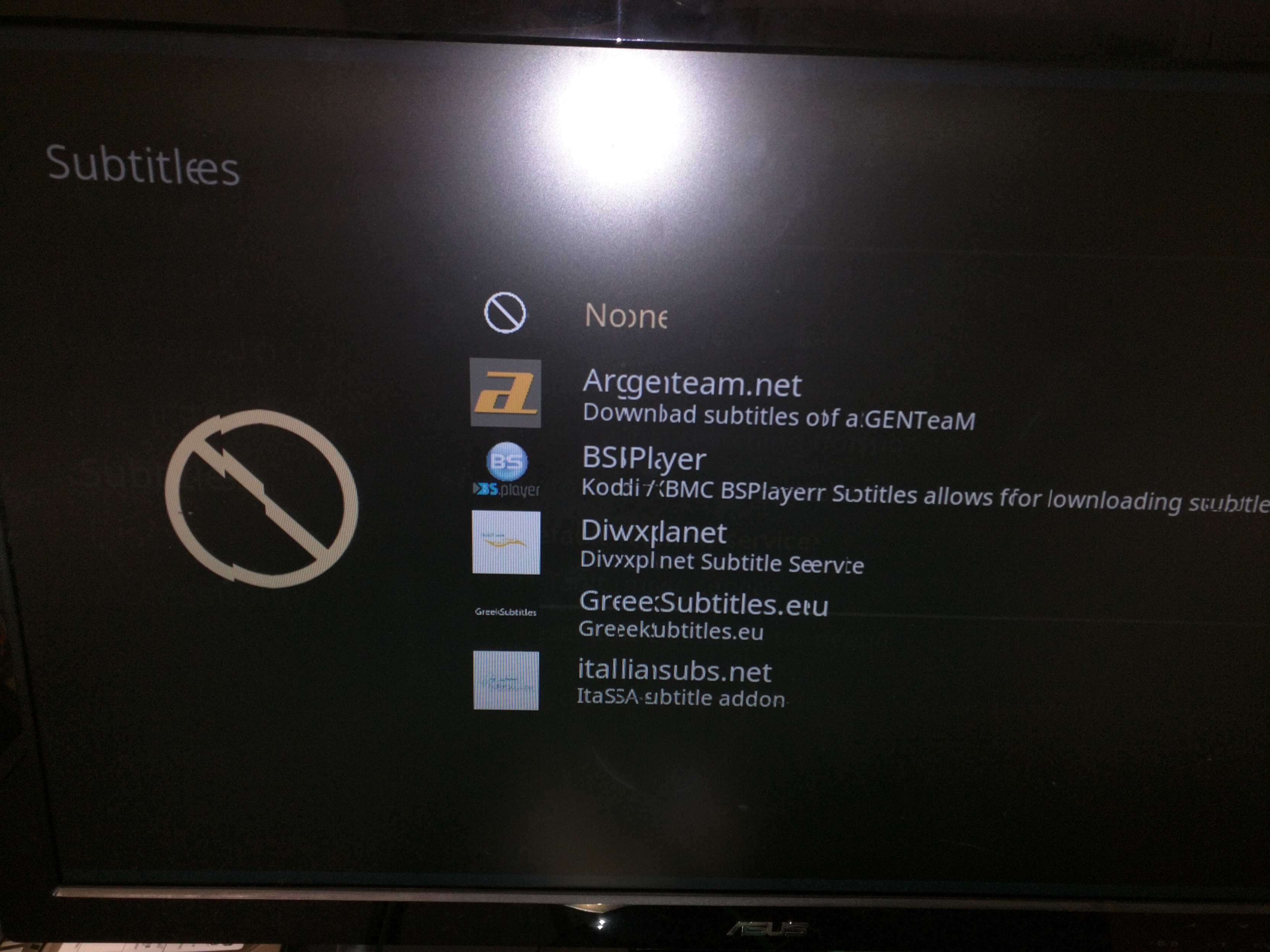

I’ve removed the add-on, but the error persists. I got Wi-Fi to work, but this happened when setting up subtitles.
It’s fuzzy and shaky, so I took two pictures to illustrate. I’m going to do a full wipe and reload next, but other thoughts are appreciated.

Also tried to remove the remote control dongle and use mouse for input. Same thing happens at the exact same place (Name your device). Maybe its related to the on-screen keyboard?
Does the fuzzy business also occur when using Confluence?
Can’t even get that far. That latest screen shot you are seeing is the “Setup”, just turning it on. It starts out in Confluence, then switches to the walkthrough which is in… the other one… (forgot the name).

Switching to confluence seems to cause it to crash too. New log shortly.

No dice. Glitch still occurs after the edit of rc.local.
At this point I’m at a loss, and assuming the unit is defective in some way. I’ve sent a letter to support to see if a replacement makes sense.
Edit: I’m going to wait for a new update coming out which may help resolve the issue. I’ll post back when done.
The update has been released. Can you try it and report back please.
Looks like the update fixed the problem! Thanks for the help @DBMandrake and Sam!
