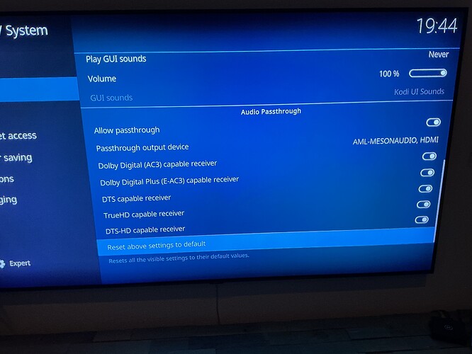

I have a Denon AVR 8500 and play atmos files perfectly well. If there is a configuration file I could share with you I am happy to do so, just might need a pointer as to how to do it.
See pictures for my settings on vero 4k+/kodi and this is connected to avr x4500h and this plays atmos as atmos.
