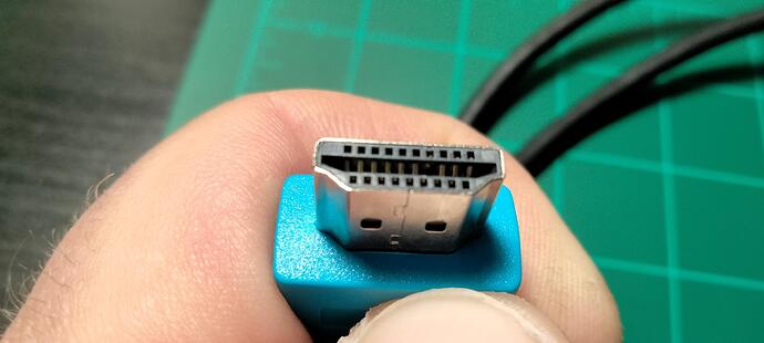

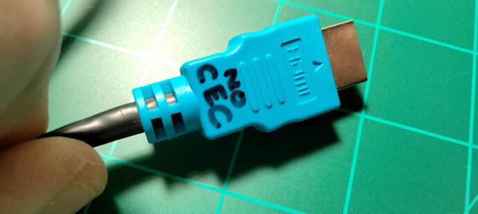

That being said, you could also just modify a HDMI cable as well to disable CEC if you have extra HDMI cables laying around.
That’s what I did.
I just pushed the pin down really hard so it has no spring to it any more and doesn’t make contact.
Works great!
