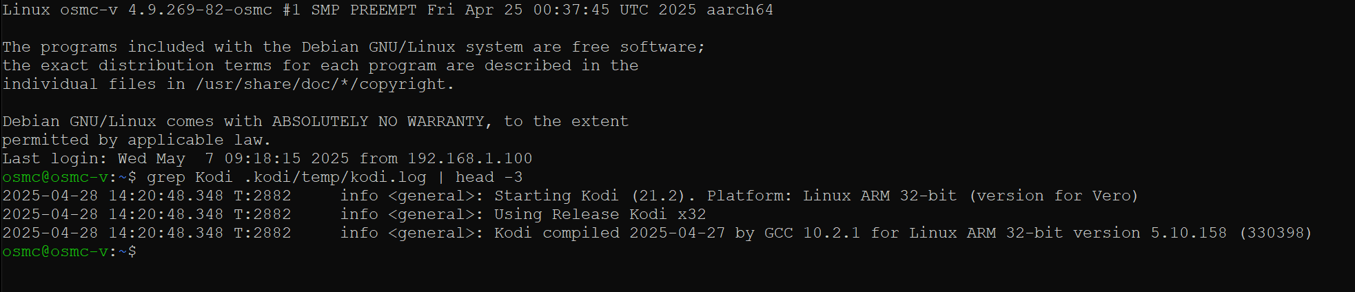

Sure but what made me confused is:
AFAIK the Vero V is based on a ARM64-Prozessor, and the Kodi currently shipped with supports 64bit as well. Hence my confusion about the advice using an installer for ARM 32bit. Is it for maximum compatibility?
Check the following - its a 32 bit Kodi.
