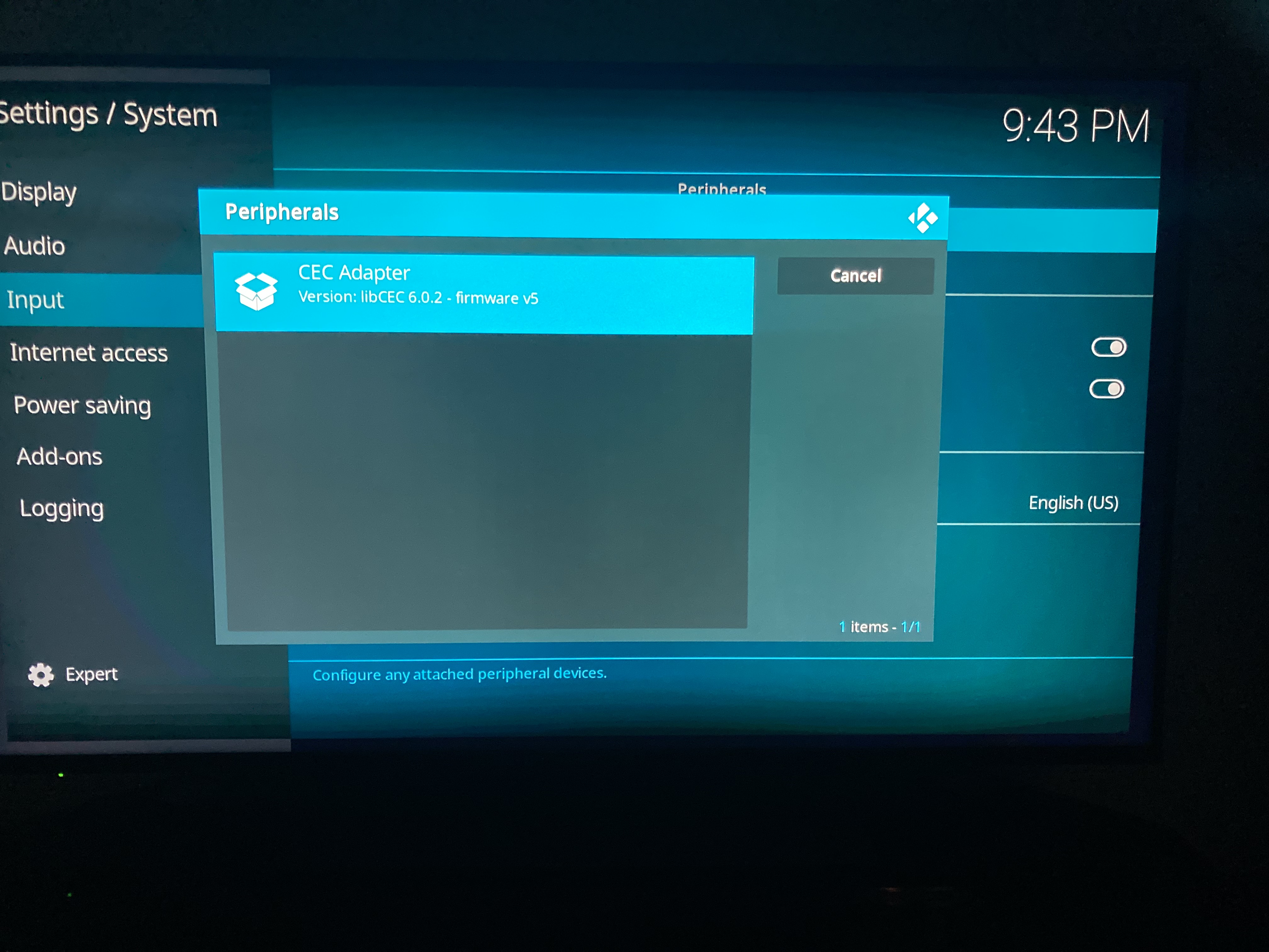

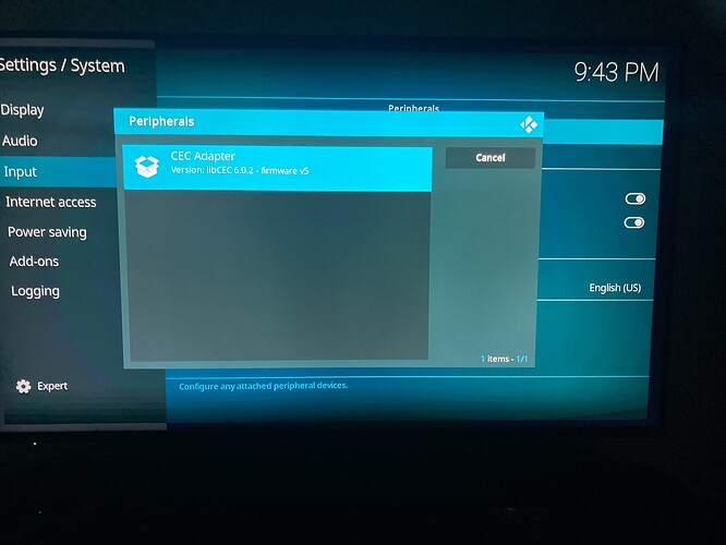

Still not working and just noticed the OSMC RF Remote is missing from the Input section.
Has that removed itself due to a hardware failure or is there a way to add that back in again?
I don’t know from that screenshot. Some logs would be good as if it appeared before it should appear again…
But as you contacted support it can be picked up from there.
