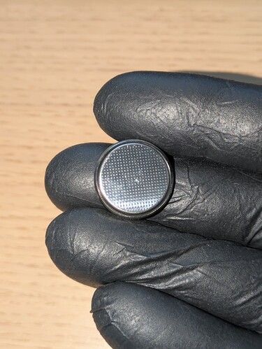

@angry.sardine Hi, here are a few more low-hanging fruits that could be causing the remote control to not work:
The negative battery contacts are slightly bent upward (I estimate 0.5 mm).
The positive battery contacts protrude slightly above the black plastic frame (also estimated 0.5 mm).
The battery should be inserted correctly.
When handling the battery, wear insulating gloves if possible to avoid electrical discharge through potentially moist skin.
If this is all fine, I agree that this remote looks to be dead if no blue light is shown with a fresh battery.

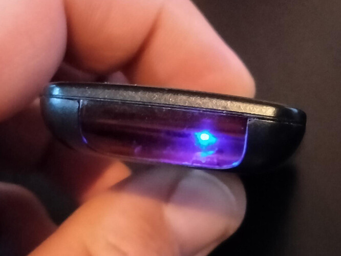

LED on remote? What LED??
There is a blue LED on the remote controller.
You have to look at the front.
It’s behind the IR window and you can’t really see the LED unless a button is pushed and it lights up blue.
