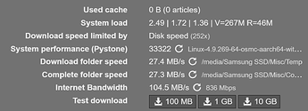

Looking to increase my download speed where disk speed seems to be the bottleneck. Would I see much of a speed increase using a SSD via the usb 3.0 port. I already have 6 drives attached via the same port on a powered hub, if that has any bearing.

I have a Samsung SSD mounted permanently to my Vero V.
I’m seeing write speeds cap out consistently at around 25-28MBps with the Vero.

I ran a quick test by creating an exFAT and EXT4 partition on the same SSD as the main NTFS partition.
The difference in write speed is pretty surprising!
NTFS:   28.8 MB/s
exFAT:  162 MB/s
Ext4:   237 MB/s
All speeds will be more than sufficient for playback.
Huge advantages for file transfers when using exFAT or ext4 though.

Given my test results above, that I primarily use a Windows laptop and that my Usenet connection maxes out at around 100 MBps, exFAT is what I’ve gone with.
