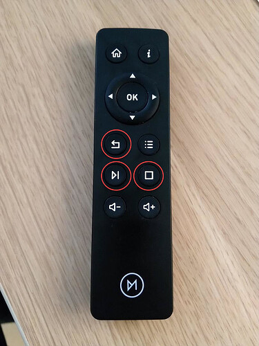

From time to time the last couple of months the back button stopped working for a while but since yesterday ‘it seems’ the Play/pause, back and stop button stopped working.
  • Fresh battery → Ok
  • Re-paired → Ok
  • Blue light when pressing button → Ok
  • Switch skin to Eminence to default → no difference
  • Rebooted player → couple of times
  • Inserted the usb-dongle from the remote into win10 pc → device found and it reacts
  • Log created : https://paste.osmc.tv/afubajediz
  • Software Version: June - Stable
  • Picture of the remote:
Thanks for any help

The USB receiver looks faulty. Happy to replace it, if we still have stock of your receiver.
