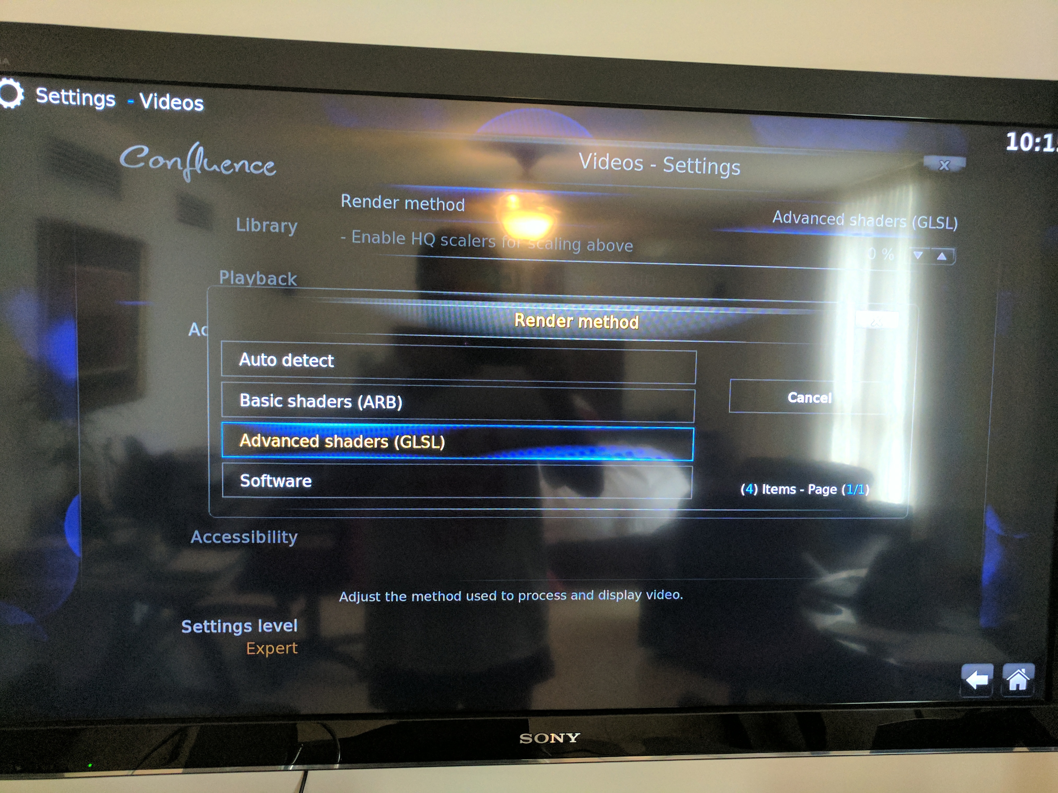

As an Old Time user of the ATV1 and Kodi, this tweak results in near instantaneous video startup and playback with OE on my SSD equipper ATV1:
Kodi Settings > System > Video > Render Method > Advanced Shaders (GLSL)
Video Cache Settings in .kodi/userdata/
<advancedsettings> <network> <buffermode>2</buffermode> <cachemembuffersize>0</cachemembuffersize> <readbufferfactor>20</readbufferfactor> </network> </advancedsettings>
This is the best startup response and video playback I have ever ever seen and will breathe a lot of new life into Kodi on the ATV1 :wink:
I’m not impressed easily these days, but this little Gem of a Advanced Shaders Tweak from a guy called VonMagnum really works very well indeed !

Thank you so much. Huge difference…
This is already the default setting in newer versions of OSMC
I have the november update installed, but it did make a difference. Should I do a clean install again?
What did you change, the advancedsettings or the shader method? I changed the render method before Jarvis was released.
Both. I fixed the shader method and created the advancedsettings.xml file exactly as above
The render method will always be GLSL. It should always be forced to GLSL. Even if you adjust it, it won’t really change the render method:
https://raw.githubusercontent.com/osmc/osmc/master/package/mediacenter-osmc/patches/atv-008-use-optimised-render-method-by-default.patch
It makes more sense to change one thing at a time and report back what really improved things.
