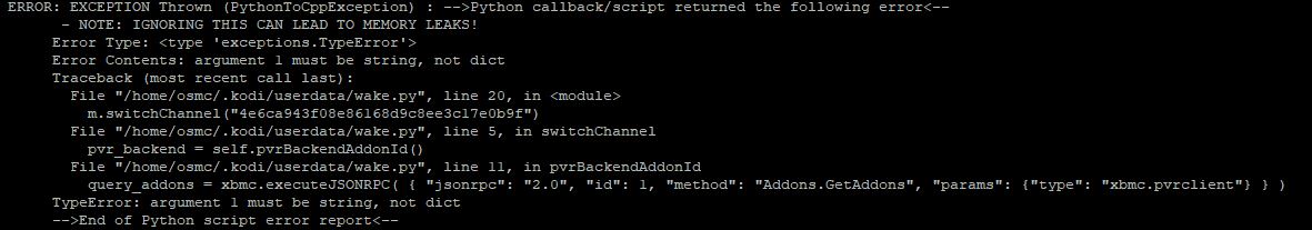

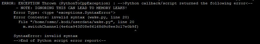

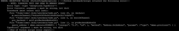

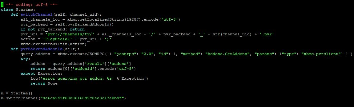

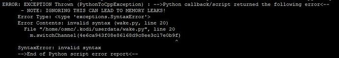

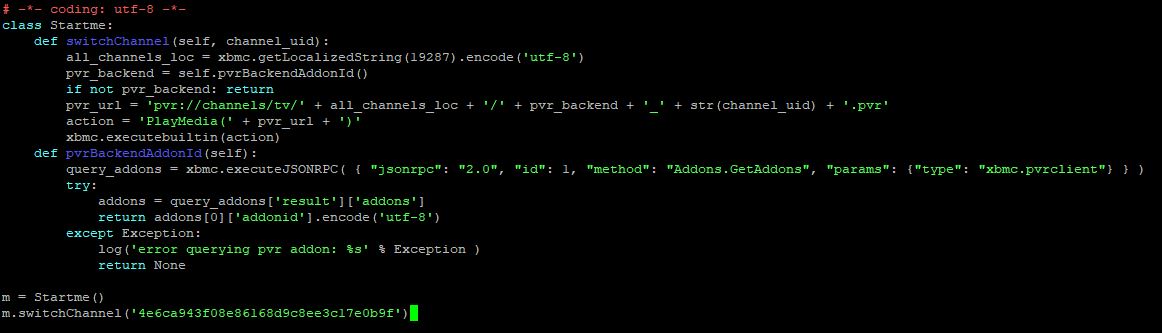

OK, I am posting screenshots: 01 and 02 are almost the same (double qoutes vs single ones), but 03 error is the same (string, not dict).
If I save my file without quotes error is invalid syntax. thx
Did you read the error that you it gave you when you used quotes? The error clearly points to the line and what the issue is. You are supplying a dict to executeJSONRPC when it’s expecting a string.
