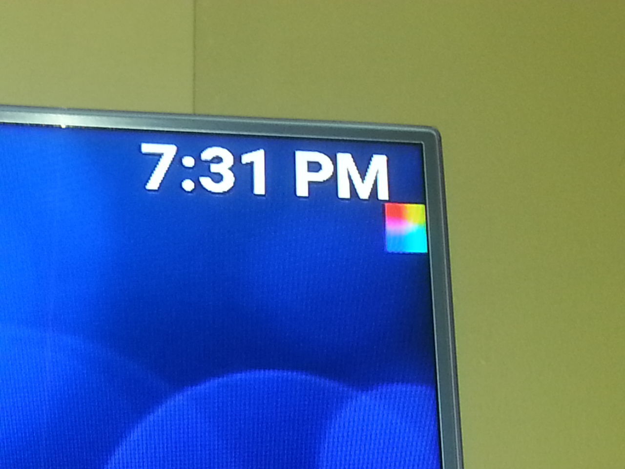

I have a Windows-like logo in the upper right hand corner of my screen (only when using Kodi). It is small and not overly annoying, but I would like to correct this. I don’t think that it is a problem with
  1. HDMI cable: tried it out with several different cables but problem persists
  2. TV: the logo is absent when used with a cable TV box
Has anyone else experienced this issue? Is there a fix?
Is it a rainbow icon?
Can you show us the logo?
If it is a rainbow logo, then this is a power supply issue. Check out this resource: Frequently Asked Questions - Raspberry Pi - OSMC.
Thank for the quick reply. The rPi is connected to an Anker 2.1 Ampere (2100 mA) power source, so I would hope that would be enough current?
It’s not. That’s definitely a low power icon, try a different usb cable
@Dilligraf: Thanks! I did not think to swap out the USB cable.
