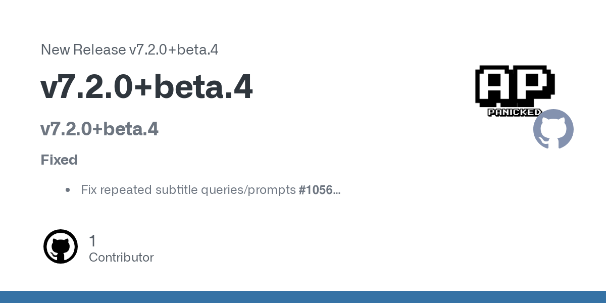

Download the beta version “v7.2.0+beta.4” of the YouTube addon from here
I used this file https://github.com/anxdpanic/plugin.video.youtube/releases/download/v7.2.0%2Bbeta.4/plugin.video.youtube-7.2.0+beta.4.zip

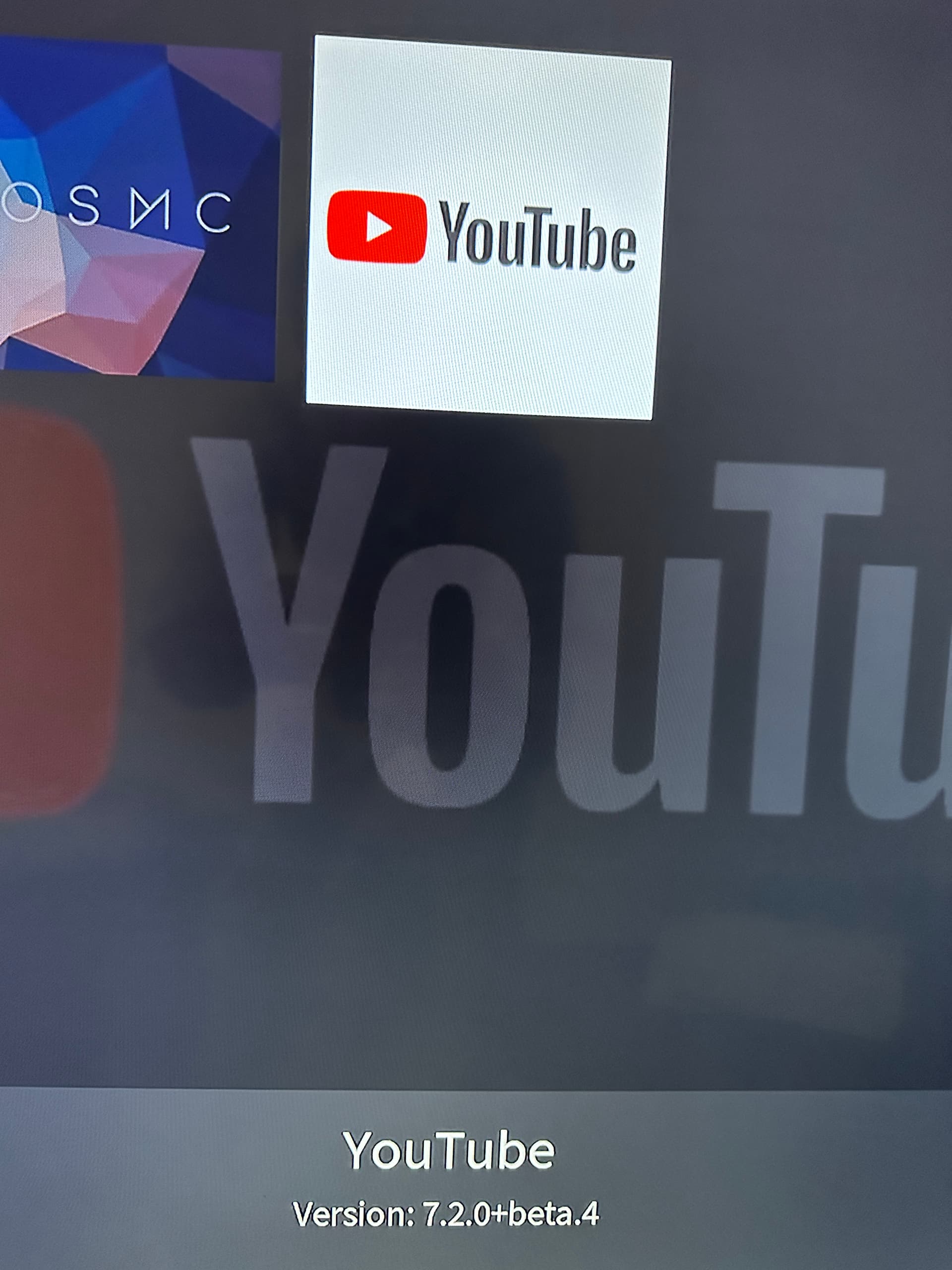

I already have the the beta version “v7.2.0+beta.4” installed.I did the sign in and it said Success! Then I look at OSMC and it asks me to sign in again with another code. I sign in to Google for the second time, and it says my device is not trusted so I selected the ADVANCED and signed it and it worked.
