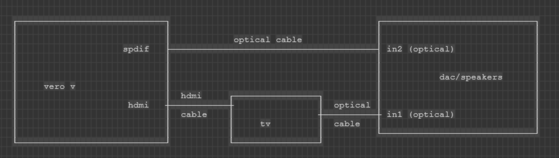

Now, this is my hardware setup:
Thing is, apparently OSMC streams audio both on HDMI and SPDIF if both are connected so I can simply switch my DAC to optical in1 or optical in2 to select one of the above audio pathways. If the audio source is a movie OSMC plays locally or off the internet, both pathways work fine.
However if the audio source is bluetooth AND I find myself in scenario 2 (music is playing while bluetooth is connecting), the direct pathway from Vero V to my DAC doesn’t work!, yet the path that goes through HDMI and TV works. I suspect there is a bug somewhere in the bluetooth → SPDIF routing.
