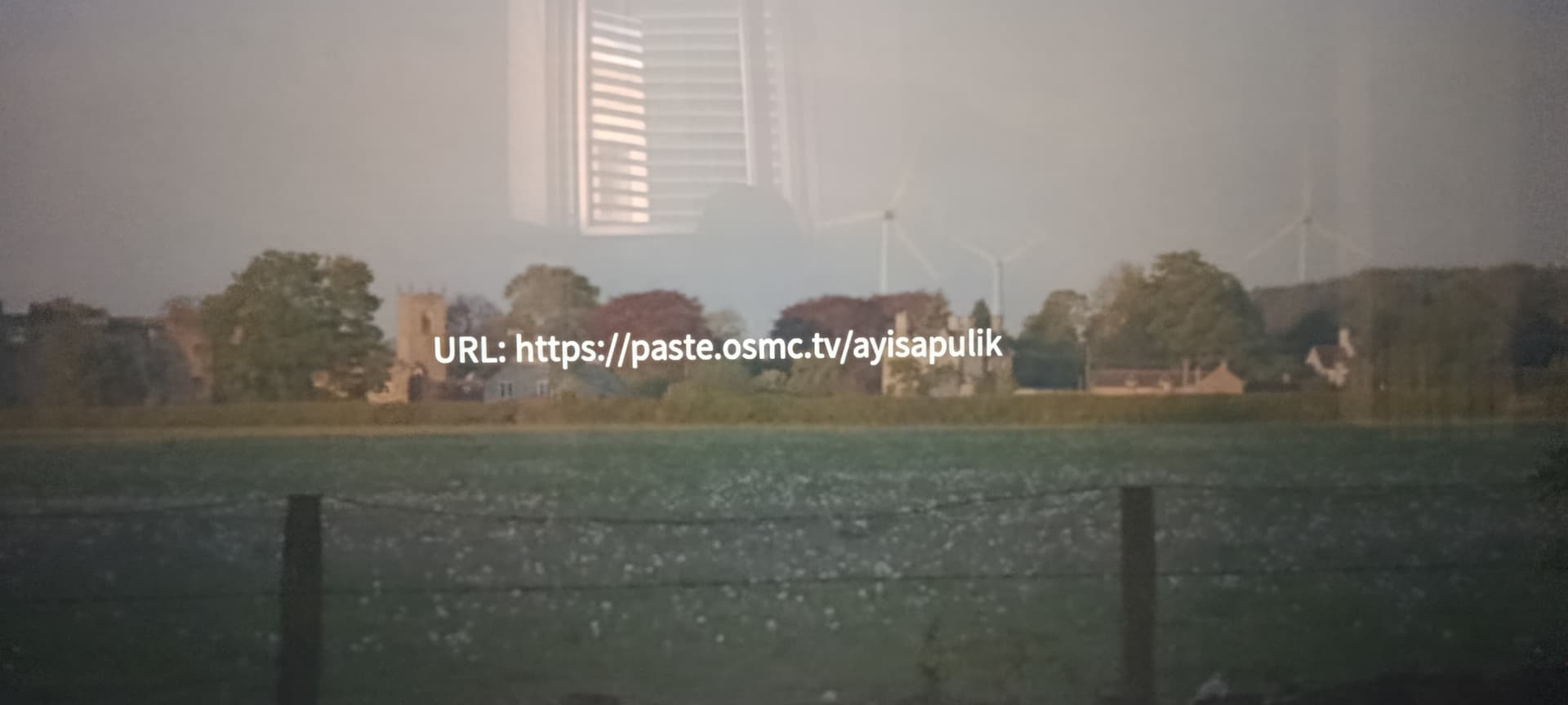

I am inserting the network address as the Vero V does not show up on map network drive (it did before the crash) The FoxT2 is SMB and it works fine, it’s certainly a bug with the latest update as I have never had a connection problem before. Why would it ask for a username and password? I have never been asked before. Can’t it be resolved from the logs that I uploaded? I did say in an earlier post that FileZilla would not connect also, I tried various connection options.

I just looked at your logs again and detected that you have Ethernet (cable) and WiFi both active.
Try to disable wifi in MyOSMC - Network
After that try to connect to \\192.168.18.5\ if that still doesn’t work try to SSH to 192.168.18.5
