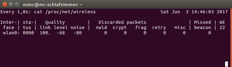

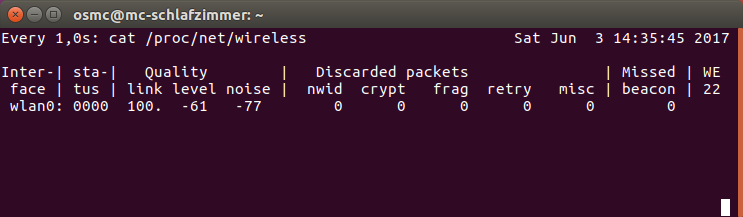

Tried out the 11ac connection again with and without background scanning enabled. Screenshots of the ssh terminal window were taken while slowly moving away from the AP. Screenshot time appears above each screenshot. Time in the terminal window indicates state of last ssh transmission.
1. Background scanning enabed
dmesg output
2. Background scanning disabed
dmesg output
So it looks like disabling background scanning does not prevent the connection from freezing at lower signal levels in this case.

By freezing I mean that the connection drops transmissions temporarily (terminal output isn’t updated), but comes back as soon as I move the RPi+dongle closer to the access point.
