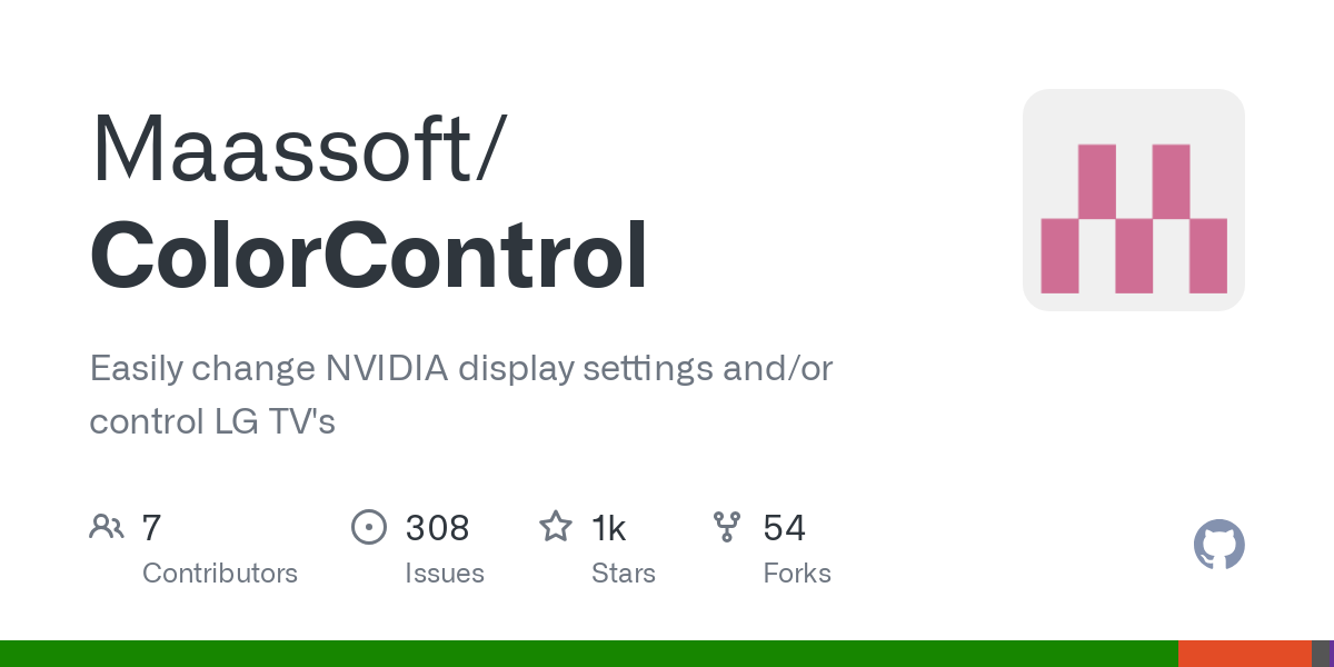

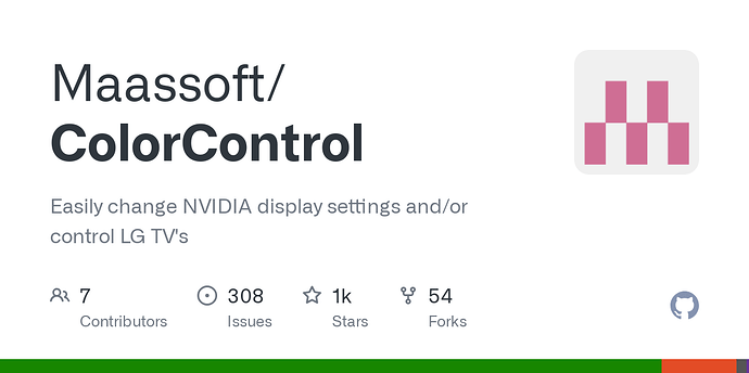

Using this Windows app it’s much easier:
The auto dimming happens whether you’re using DV or not. Using that app you can turn it off (I have a C9 as well).
