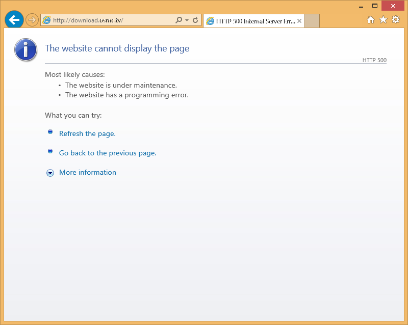

Hi Sam,
The browser connects to the site… we receive Error 500, thus I don’t believe it is a network access issue.
Please see attached image… I got the screen shot from IE 11, the same occurs with Chrome and Firefox and on other PCs. I also tried the same website (as well as paste.osmc.io) from my mobile using a 4G connection (not using the metro Ethernet connection of the local network) with the same results.
It might just be a temporary network glitch. See if you get the same problem accessing apt.osmc.tv in a browser.

Same with that… therefore, apt.osmc.tv, download.osmc.tv, paste.osmc.io are not accessible from any browser (fixed connection or mobile), they produce Error 500.

This has started occurring about 3-4 days now and all three websites are still inaccessible. The main website, www.osmc.tv, and the forum are running properly with no issues. Furthermore, the paste-logs command from the SSH command-line works properly even though access to paste.osmc.io is not feasible through the browser.

I checked http://apt.osmc.tv and I get an error 500. I then checked https://apt.osmc.tv and I get an invalid SSL certificate for that host. I suspect that this might be the source of both issues, as the OSMC installations cannot connect to the repo (I might be mistaken however).

The https on apt.osmc.tv does go through BUT it provides an erroneous cert, thus an exclusion should be made otherwise the session will not continue. On the other hand, the repo-used http://apt.osmc.tv gives error 500. The latter I believe is the source of not being able to update the various Kodis…
Just retried http://apt.osmc.tv . It now redirects to Index of /osmc/osmc/apt and it does not give Error 500.
