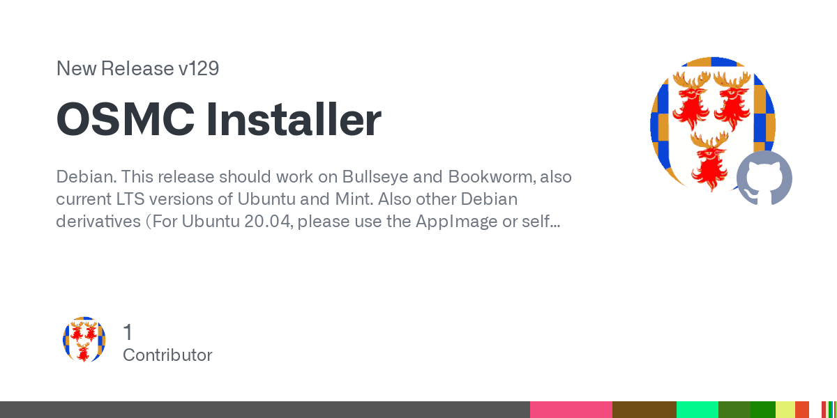

Hi Linux Users,
I’ve been trying to bring back the Linux OSMC Installer and I’ve tested across various Distros and I’m happy with the results. I’d like to expand the testing pool to pick up any bugs I may have missed. I would appreciate it, if fellow Linux users would please test the below releases:
Update 05/07/2025
New release details and downloads can be found here:

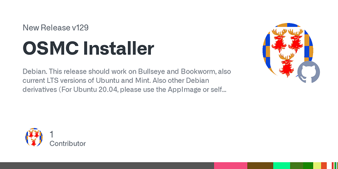

Update 25/10/2022
Update 19/10/2022
New release, includes Appimage. More details can be found here:
Update 24/06/2022
Display issues reported on resolutions above 1080p. I’ve created a test release for Debian and its derivatives, (can sort out an RPM if there is any interest).
I would appreciate tests on resolutions greater than 1080p (won’t display correctly on 1080p or below), screen shots would be good as well.
Original Release
Debian. This release should work on Buster and Bullseye and current versions of ubuntu and Mint. Also other Debian derivatives.
Redhat. Should work on on 7 & 8 and Centos 7 & 8. Also Rocky and Almalinux. Also other Redhat derivatives and should also work on Suse as well.
Any issues please reply to this post or raise an issue on my Github.
Positive feedback will be greatly received as well.
Thanks Tom.
