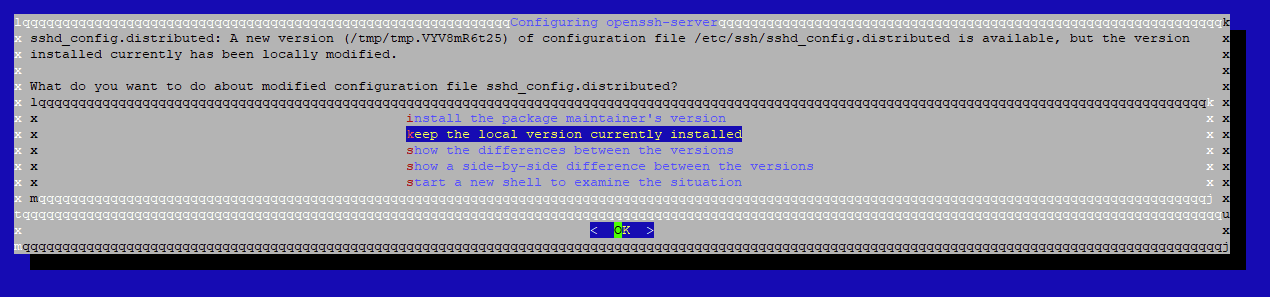

via ssh I’m being prompted whether to install package maintainer’s version of a configuration file in /etc/sshsshd_config or keep local modified version. This has nothing to do with any mod on my part, never heard of this config before. Which one should I pick?
We normally avoid those things. I would go for keep the local version.

I usually keep the local version, any changes that i’ve made were made for a reason but you are saying that you’ve not made any changes so this would be interesting to see what the differences are, i’d be worrying that something devious has gone on.
