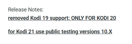

Hi Sam,
I think you are mis-interpreting the statement: v11.x of the plugin doesnât support Kodi 20, but that does not mean that v10.x of the plugin doesnât support Kodi 21.
In fact, in the v9.x plugin thread on the board, it states
So v10.x was developed for Kodi 21 support ![]()
v11.x is in public beta as the next release.
