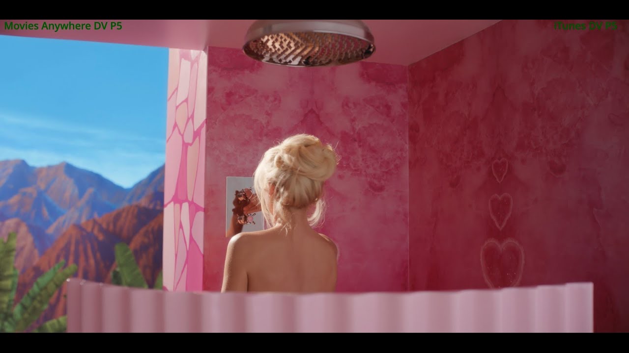

C2 and G2 have/had a know issue with DV, see here:
I don’t know if it has since been fixed and/or if newer gen TVs like the C3, G3, C4, and G4 are affected.
According to this guy, and he seems to be the guru when it comes to DV, he says all Apple Profile 5 DV streams, regardless of whether or not they are Apple Original content, do have a red/orange push.
Not to confuse it with the orange banding on skin tones, which you guys fixed, that was a separate issue which also effected other bands like the blue in the 12 Monkey snow and the Gattaca and Aliens openings.
But people should be aware of this difference moving forward and not blame it on the Vero V.
Good spot. So we can now see that those clips that showed that black/white inversion probably came from Apple. They use the P5 reshaping in a weird way.
But I didn’t hear anything about a red/orange push. He just says it’s ‘washed out’.
