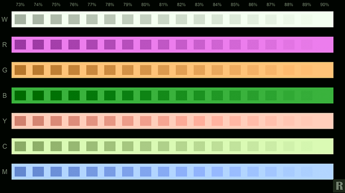

I am noticing something slightly weird though, I’m surprised I’m the only one so far. I’ve only tried DVP 5 and DVP 8.1 but see the same issue on both: the colors are a bit more saturated (pop more) and/or the peak brightness is noticably higher when compared to the TV’s integrated Kodi or the TV’s internal player.
  • Vero V with kernel 4.9.269-76 (installed yesterday)
  • LG OLED G3 with brew Kodi v21.2 installed (its picture looks the exact same when played off USB with the internal player)
  • LG OLED C2 with bew Kodi v22.0 installed and with the internal player (USB)
  • same exact picture settings for the HDMI input of the Vero and the internal apps/players, all “auto” settings turned off (e.g. “auto brightness” or “AI brightness”).
  • when played directly on the LG’s internal player, the DoVi video looks very similar to the HDR10 variant
  • but on Vero V, both DVP 5 and DVP 8.1 look oversaturated/overbrightened
  • the HDR10 variant looks fine on the Vero V
  • the same DVP 5 video but with HDR Processing: Force HDR (no DV) also looks fine
I have a 90 MB sized test clip (DVP 5) which I uploaded here. You can see the entire picture is brighter, sun rays peak noticably more, and the red hair and jacket also pop a bit more.
I remembered I had DoVi calibration videos from R.Masciola and I compared the Color Clipping > 01. HDR Color Clipping High_Dolby_Vision.mp4 between the Vero V and the native TV player.
It looks sort of like this (ignore the wrong colors in this picture, it’s a PC screenshot)
Here’s how the native TV player (left) compares to the Vero V (right):
   TV / Vero
W: 89 / 80
R: 82 / 81
G: 86 / 80
B: 89 / 84
Y: 89 / 82
C: 86 / 79
M: 83 / 79
As you can see, the output from the Vero V clips much sooner for all colors (and especially white/brightness). This indicates Vero V’s DoVi output has oversaturation and/or a PQ curve that is way above reference.
(Unfortunately, I don’t think I can share that video file, since it requires a license).
Thanks for the feedback. It’s difficult to say what is ‘correct’ output from Vero. And I guess it would be disappointing if the DV version looked the same as the HDR10 version.
You’ve correctly mentioned that TVs have different settings for different inputs. On my TV DV from HDMI is blessed with only one setting: DV bright or DV dark and the dark setting is useless. I think other TVs are similar. I’m not sure there are any settings for the internal player. Having said that I, for one, haven’t spent much time comparing output from different players, and measuring the output accurately is difficult, so your findings are useful.
We jacked up the brightness in the latest build because @ac16161 mentioned SDR output was too low. We can have another look at that.
Edit: FWIW I’m getting this with Vero feeding my Philips OLED:
W: 88
R: 83
G: 81
B: 83
Y: 87
C: 81
M: 76
Not sure yet what to make of that. But assuming 90 corresponds to 4000nits and 75 corresponds to 1000 nits I doubt the differences measured with that pattern will be noticeable on typical content.
As for your test clip. Yes, it’s a tad brighter than with the internal player on my Philips OLED but I’ve not seen any obvious white crushing. TBC …

I lied. This morning I discovered there are other settings when DV is being played under an Advanced tab. The UI on that TV is terrible. Made sure the settings are the same for all scenarios.
My point is, a difference in roll-off above 1000nits would be hard to spot. The differences we see on that test card are because the mid-tone contrast is higher, pushing up the knee point - that’s what is easy to spot. We’re probably saying the same thing :stuck_out_tongue:
I can see a difference so further confirmation not necessary at this stage. We just need a method of measuring it so we can see what adjustments might help. Stay tuned.
