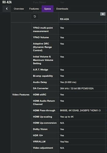

I have selected a different HDMI input for the Vero-V on the AVR (Yamaha RX-A2A) which supports slightly different features than the one it was originally connected too. This has stopped all the stuttering.

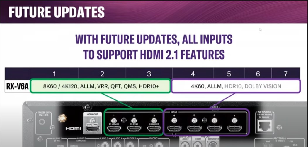

i.e. the Vero-V is now connected HDMI Input 1 rather than HDMI input 4 as shown in the photo below (which is for a RX-V6A Yamaha AVR which uses the same HDMI board as a the Yamaha RX-V6A).
I think this is a little out of date, so am going to research a little more.

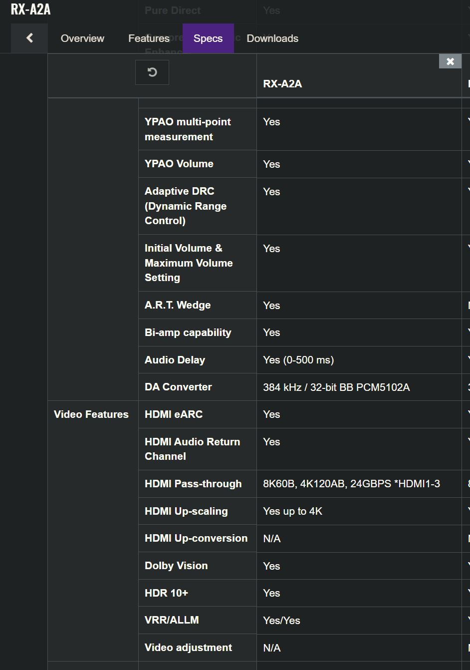

I suspect that the problem was to do with HDMI Passthrough only being implemented on HDMI Inputs 1 thru 3, as shown from the specs below. The Vero-V is now on a HDMI Passthrough port (to the TV) .

Yes, the issue I think was really to do with the way AVR handles HDMI passthrough (although the audio is captured by the AVR, on its way to the TV).
The HDMI input ports do behave differently depending on the device connected (and the quality and (non-) conformance of the different CEC implementations).
