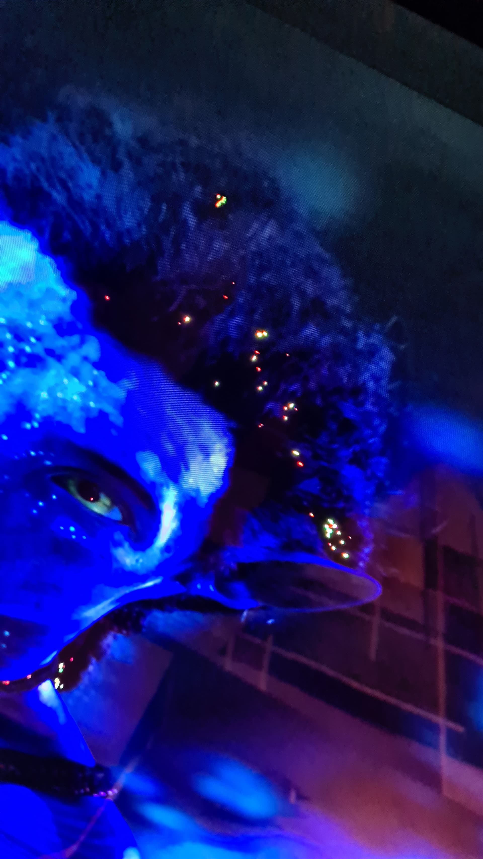

Hi, i installed DV patch as described, after some struggle with settings params (force 422 = false, use limited color range = true, reboot device) the dolby vision started to work. LG CX tv recognize dolby vision content but somethimes i can see burned pixel in pictures. See attached image. What can i to do with it?
1)i’ve change hdmi cable also.
2) sometimes half of screen is burned or large area of picture
So many things could be causing this from bad rip to display calibration. If you upload a short clip which shows the problem we could check it out. Upload debugs logs for a start, though, so we can see the video type and all your settings.
Adding more details:
  • It happend for all DV what i tested.
  • I migrated vero 4k into vero V via osmc backup. Can this have affect on it? I think to try new instalation of osmc.
  • some DV are correctly played with plex od lg cx dlna player. It means DV source should be correct.
LOG:
https://paste.osmc.tv/xucipotade
I can’t immediately see anything unexpected in logs.
