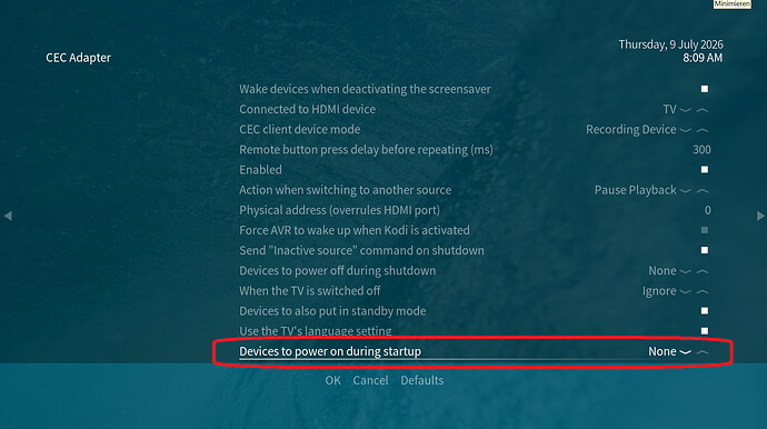

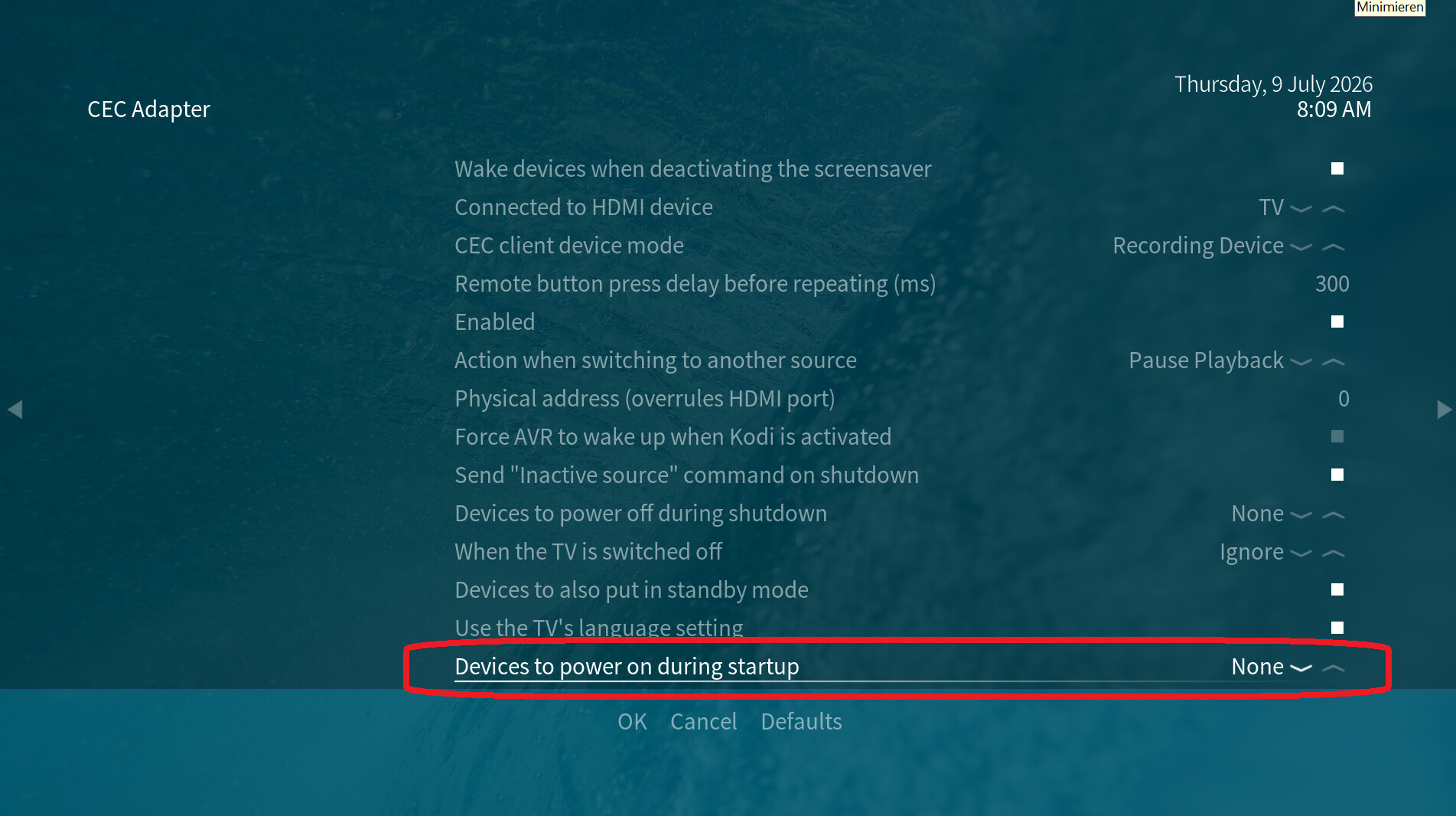

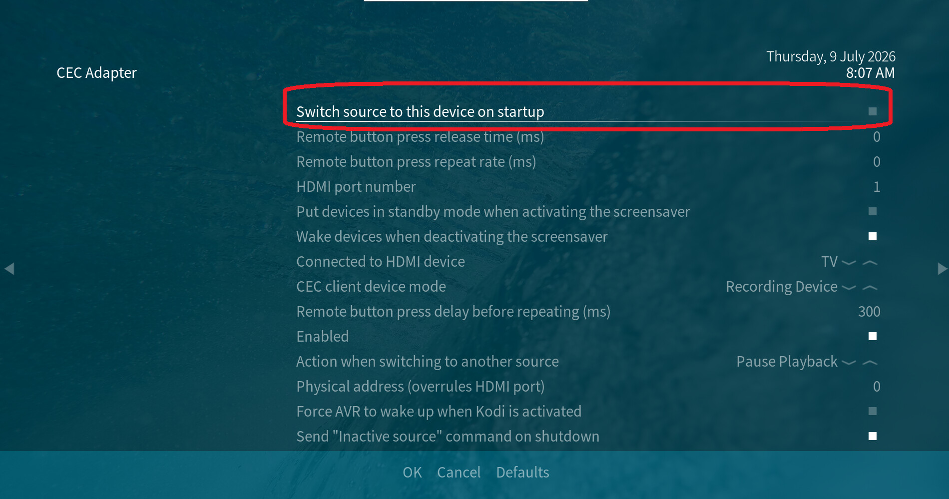

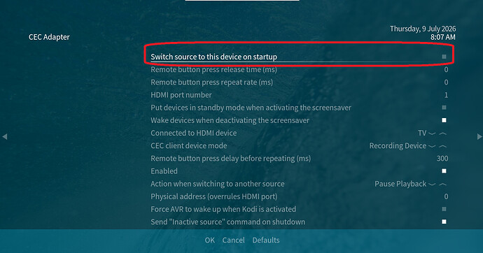

I have a hunch, and you could simply try the following:
In the menu settings -> system -> input -> peripherals -> CEC adapter
set Devices to power on during startup to none and perhaps deactivate switch source to this device on startup. In the example screenshots all other settings are default;s only touch the both mentioned flags.
Please report what has changed for you as a result.

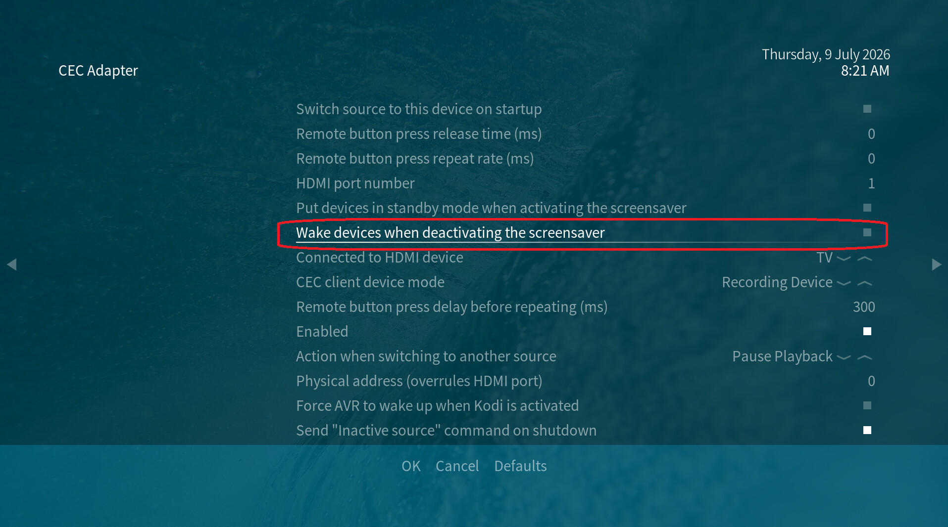

Wake devices when deactivating the screensaver is another feature you should disable for now.
OK, as soon as I turned off Switch source to this device on startup I lost CEC control completely via the TV remote (so had to switch to using Yatse on my phone). Turning back on didn’t give control back, so I turned everything off (shutdown Vero V and started again) and when it started up it turned the TV back on again. This time, when I turned it off, the AVR auto switched from the current input back to my default TV input (thus losing the signal) and the TV remote was working again.
When I switched the AVR back to the Vero V input, I could go back one menu level, but then got stuck there and couldn’t go any further using the TV remote (the AVR remote didn’t do anything also), so had to go back to using Yatse. This time I left Switch source to this device on startup disabled and shutdown, turned on again and this time when the Vero V started it didn’t auto switch on the AVR (as expected, I suppose). Then when I turned the TV back on and selected the Vero V input on the AVR, I regained control using the TV remote again.
I switched to TV and the AVR switched to the TV input, then switched back to the Vero and the AVR switched to the right input.

I have now also changed Devices to power on during startup from ‘TV’ to ‘None’ and unchecked Wake devices when deactivating the screensaver.
I shall continue to monitor.
