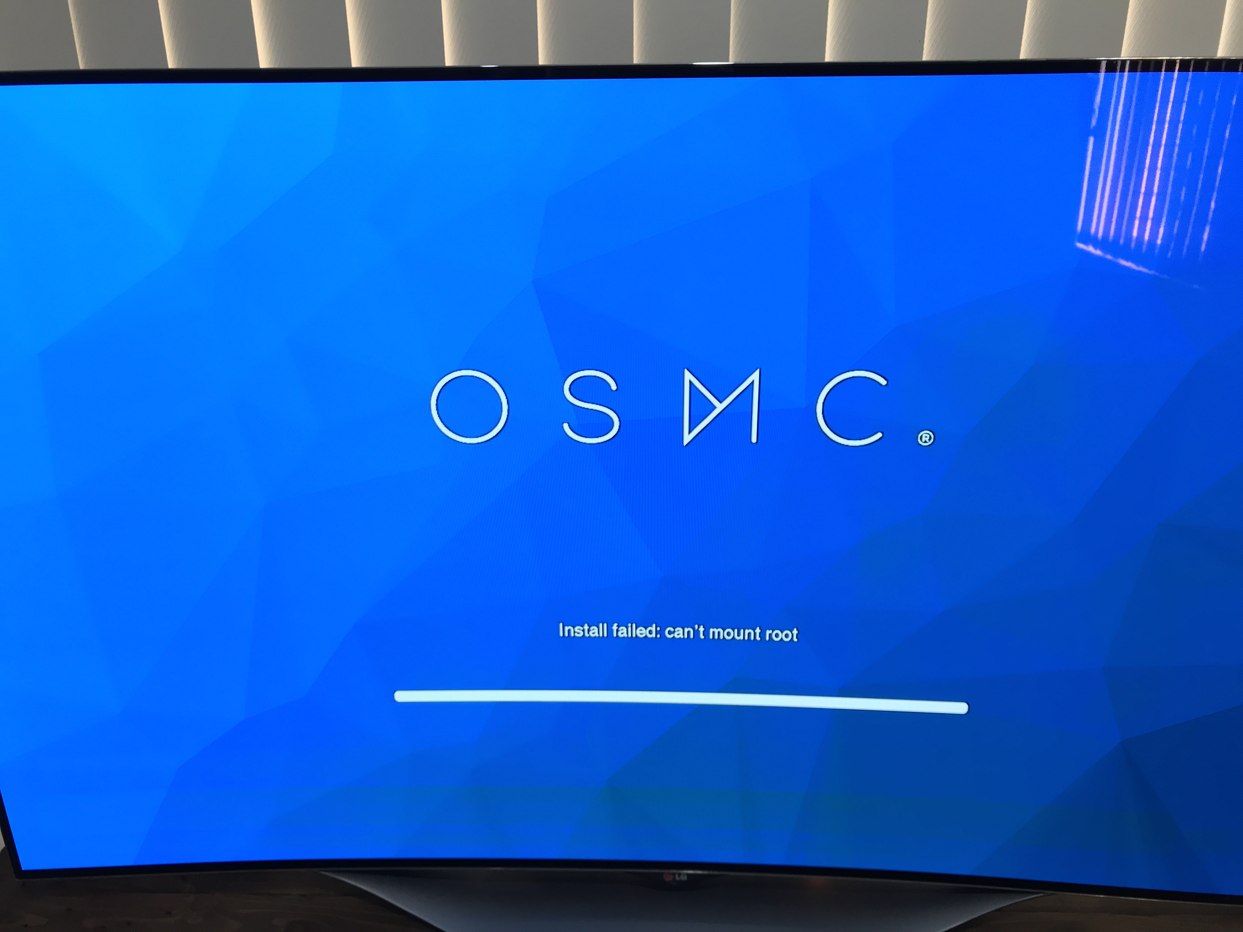

OK, just so I am clear on this, you’re suggesting I should follow the steps to force the system to boot from the SD card even though I’m using a brand new SD card and the system is recognising that I am trying to reinstall from the SD card as shown here:
As I understand it, the toothpick technique wipes the internal memory so that there can be no confusion about which device (SD card or emmc) the vero is booting off. If you have already tried that then I’m out of ideas.
The picture above shows that the installer is running, so I am unsure why it is unable to reinstall OSMC.
