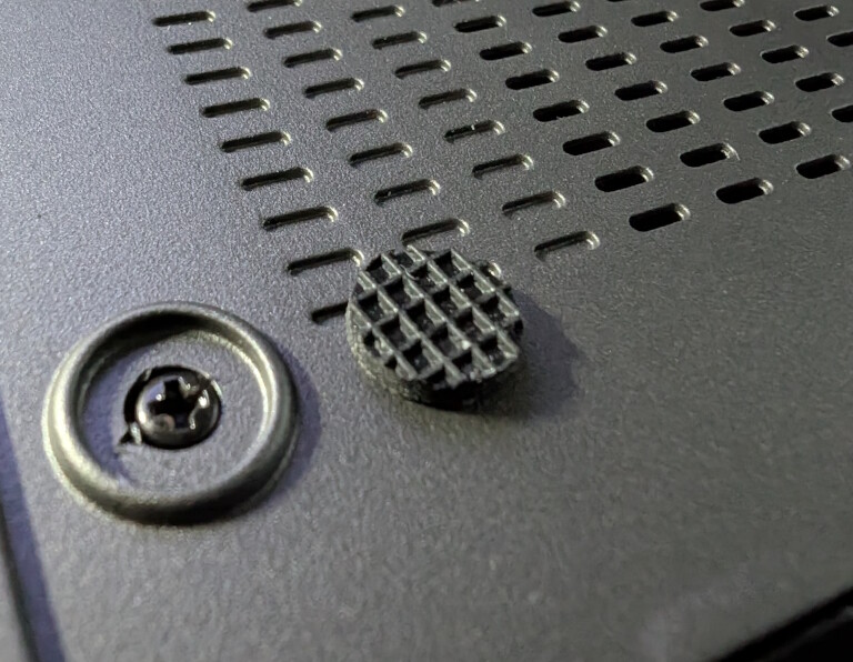

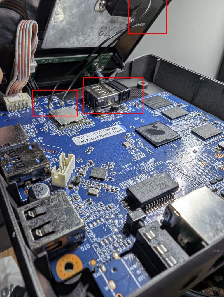

Today, I decided to just open it up to take the adapter out from inside. Feel I need to state, do this at your own risk. There’s four screws under the feet and then the top pops off with a few clips holding it in place, don’t rip the top away as the aerials are attached on short wires.
I took the adapter out and have tired it in both the external USB3 and USB2 ports.
Frankly my USB3 port seems dead… and I’ll assume the internal port (didn’t try plugging anything else into that before closing it back up), as the remote now works again, I’ve plugged the adapter into the external USB2 port and the remote is working fine.
I’ve actually had to plug a USB splitter into the external USB2 port as well to get two USB ports, but the remote worked fine with the adapter plugged in directly and also via the adapter now.

PXL_20260130_153654236
Please excuse the broken resolution, I got tired of trying to compress a gif to under 4mb.
I found an old USB stick that lights up.
My hand is partially blocking the USB light to first time I plug it back into the USB3, but the second time you can see it clear flash the once and that is it. Doesn’t register at all.
Edit:
I’ve also tried restoring the device to any earlier software version from Index of /osmc/osmc/download/installers/diskimages
I went back to OSMC_TGT_vero5_20230807.img.gz, made no difference, USB 3 port still didn’t work. And FYI anyone else thinkin of trying this, I had to reconfigure everything, it formats the device.

USB Device External USB2 External USB3 Internal
SSK Mounts okay Mounts okay Nothing, no signs of life
Red SanDisk 2GB Mounts okay Single light flash, doesn’t mount Single light flash, doesn’t mount
Black Promo USB Mounts okay Nothing, no signs of life Nothing, no signs of life
Less signs of life from the internal port. I can’t get any of the three USB sticks to mount. The only sign of life is the single light flash on the Red SanDisk, the same symptoms as the external USB3 port.
