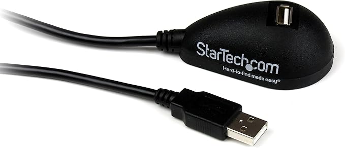

Are you using an external replacement dongle or is it using the internal dongle?
If you have an external dingle you could also just get a USB A male to USB A female and move the dongle away from the Vero V.
Something like this would work:
https://www.amazon.fr/-/en/StarTech-com-1-5m-Female-Extension-Cable/dp/B001K9BFB8?s=computers&sr=1-15
