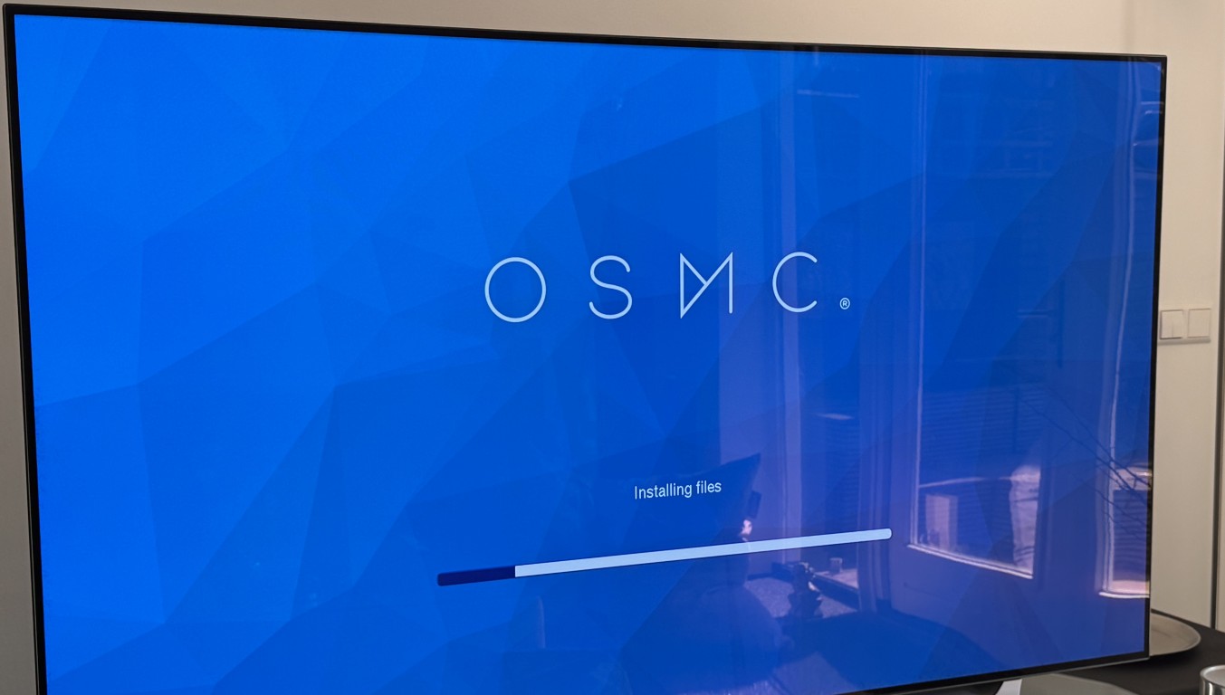

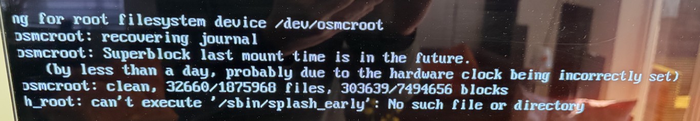

Ran the 2 commands, rebooted and spalsh screen stayed on the S905x4 logo, could nog get in via ssh.
Next best thing, download the image and install via USB, but on both the 2025.10-1 and 2025.03-1 i get an error after initial installation:
This is the install.log which is on the usb:

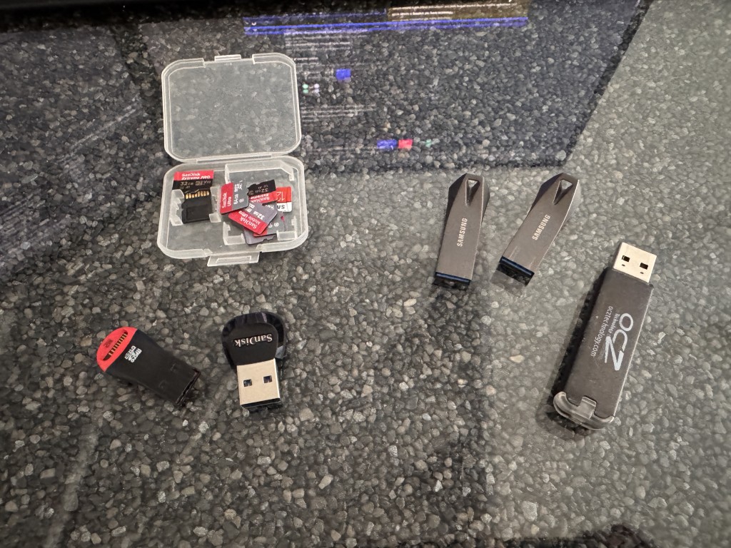

Used both USB ports, also tried balena etcher to write image to usb, tried 3 different usd drives.

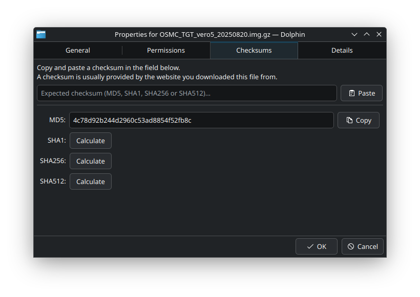

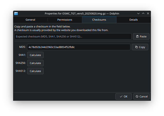

Can you give me the checksums of the images you downloaded?
Both match as far as i can see…
rozz@uPower:~/Downloads$ md5sum OSMC_TGT_vero5_20250303.img.gz
b9d01f9fe8da82c0dfc39bb49cf29c5e OSMC_TGT_vero5_20250303.img.gz
rozz@uPower:~/Downloads$ md5sum OSMC_TGT_vero5_20241104.img.gz
7fd501da3075ce0a49a8889c087df907 OSMC_TGT_vero5_20241104.img.gz

How many USB devices have you tried?
Have you tried an SD-card?
Thanks for the reminder @JimKnopf, i tried it just now and the installs goes through OK!!!

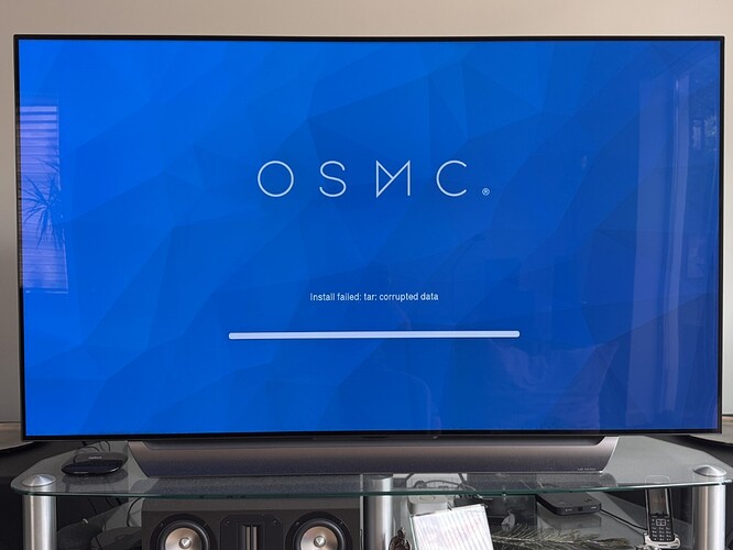

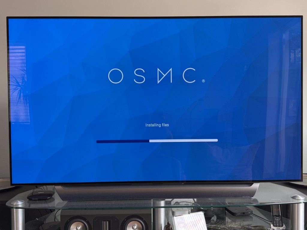

But no matter how i try, it fails everytime with the corrupted data error

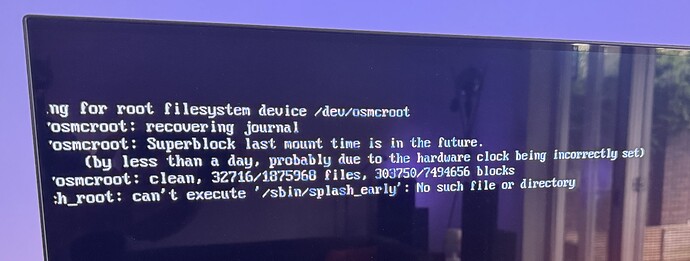

Here is the full fault, exactly the same as when i first started this thread, but now not even trying the sd card works.

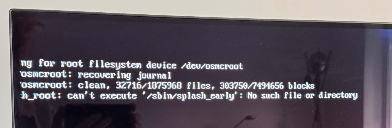

Thanks Sam, but still no go.
I tried both usb ports and the sdcard slot, with and without all the others cables installed (network, hdmi, optical)
Also used a usb stick with activity led so i could see if it was being accessed.
After pressing and holding the “reset” in the 3.5mm port (nice touch placing it there btw) inserting the power cable, after about 10sec removing the toothpick, no activity shown on the usb, the 10 sec is about the same time when the blue led turns off after powerup.
Also tried different times to let go.
Waited arround 10min after every try
Seems the exact same thing as what “daytooner” had: Vero5 is now a brick
Daytooner resolved the issue by using another USB.
You could also reinstall OSMC using a USB A to A cable
What do you see on the screen if you try again with HDMI connected?
Sam, believe me, i tried lots of different usb sticks and micro sdcards
Just tried a usb-A to usb-A extension cable, i thinks thats what you meant? still no difference.
Thanks to the activity led on the OCZ usb stick, i can see activity, when plugging in the power with the button pressed, i can see it sees the usb, but when the blue led goes out, it doenst read the usb anymore and comes to this screen:
I tried different times in holding down the button, all no difference.
When the hdmi is looped through my receiver is see this screen very briefly and ends with above screen again.
Sometimes it ends with this screen, depends on which usb port i think:
