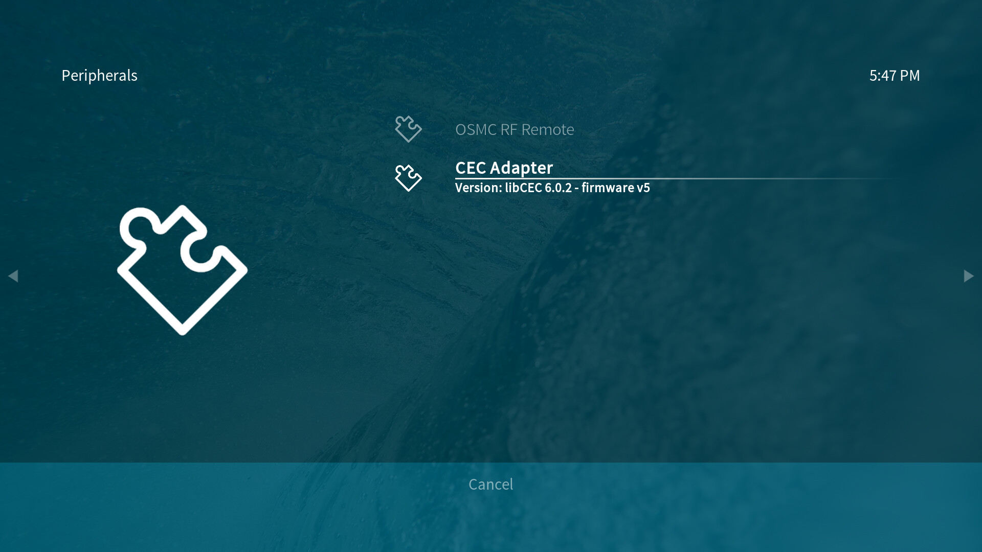

Hello casperklein,
I’m just a casual user of Vero 4K+ and Vero V and I would add to that reflection that to control my vero with CEC I use to go to settings → system → input → peripherals → CEC Adapter in KODI interface to configure the actions to do when vero V turn on (turn on TV) and when I turn off my TV (turn off vero).
I hope it will be usefull for you (and others).
